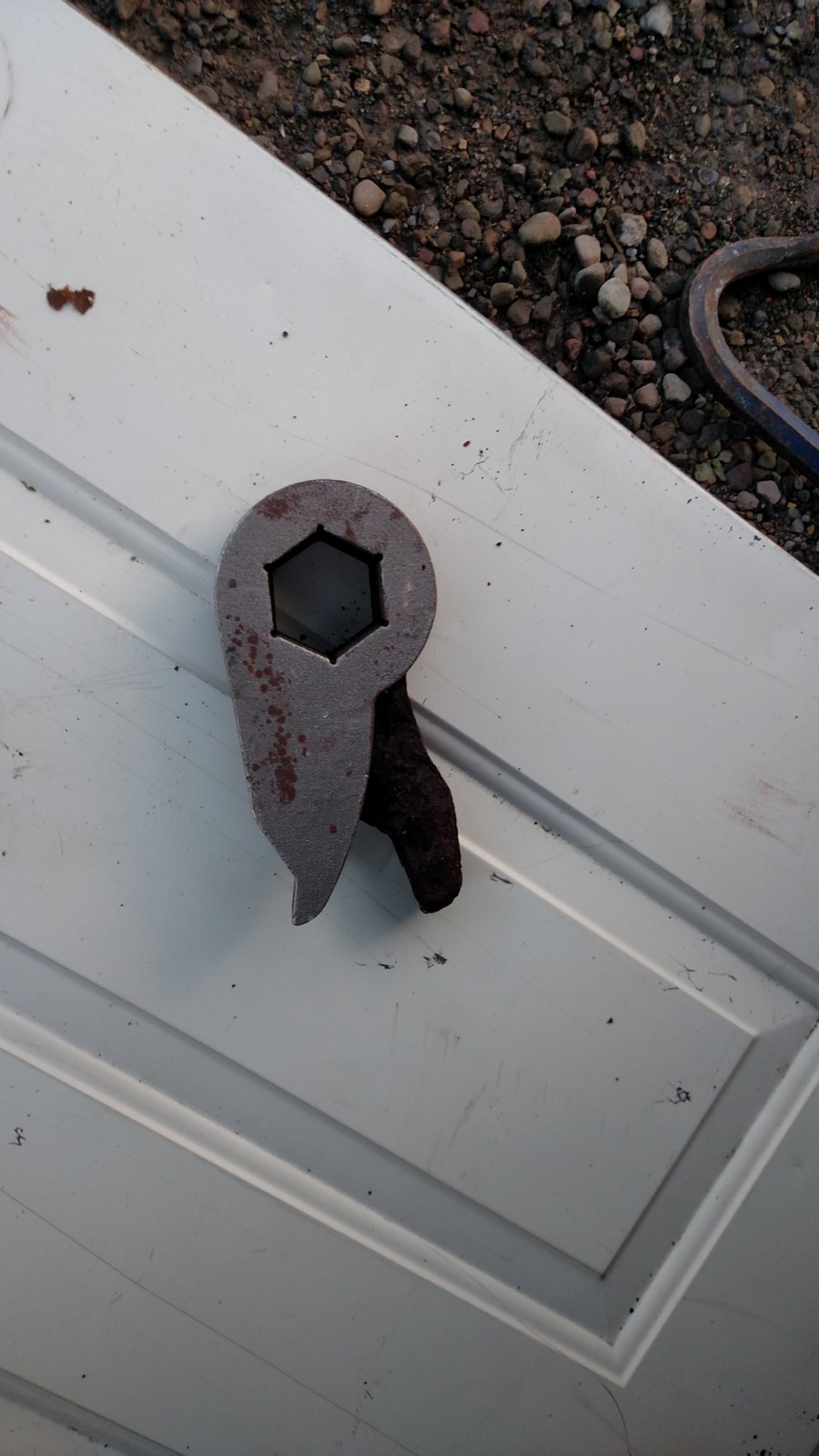

The keys below are a stock Chevy key on the bottom, and an F150/Expedition lift key on the top. You can see how much more the Ford keys are indexed... in fact, TOO much. Mind you, these are LIFT keys for the Ford, a stock Ford key wouldn't have as much difference.
I have these at zero extra crank, the passenger side is resting on the little bar in the TB key mount with the bolt just to snug, and the driver's side has about 3 turns, just enough to bring both up to the same ride height. I'd say I'm at just about 3" of lift with these keys. My upper control arms were practically resting on the stops, so I pie-cut the underside, and bent them down about 3/8", and tack-welded them back together. A free-travel mod for us lifted guys, if you want to call it that. My fender heights with 34.1" tall tires (275/65/20's) are at 39 3/4" front and 40 1/2" rear.
IMO, if all you want to do is bring the front up a bit to make it match the rear, there is no need to buy ANY aftermarket keys, unless your torsion bars are worn out. The stock keys have enough room to be cranked up, nearly 2". If you do add keys to raise up over 2", then the rear end will be lower, unless you either add Z71 springs, rear coil spacers, or both.
