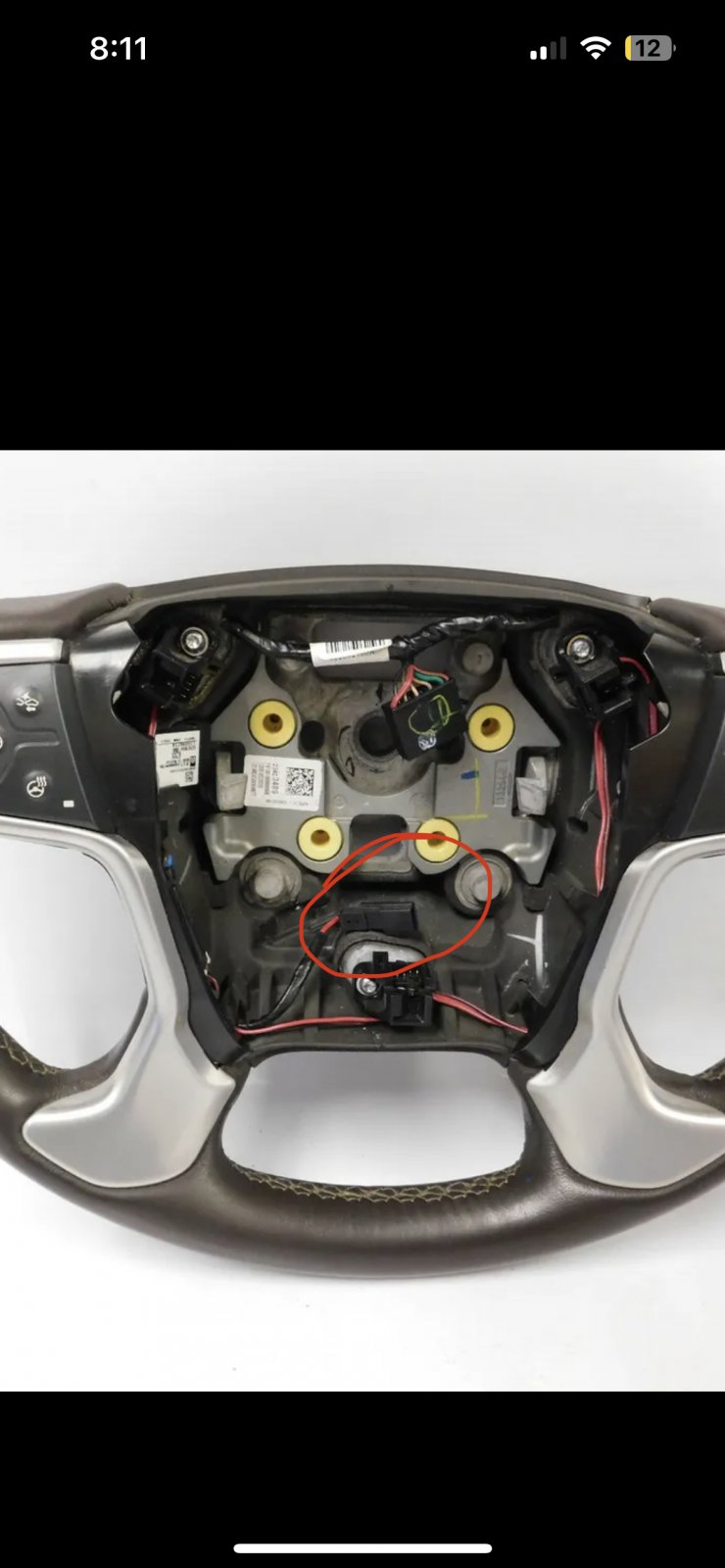

@Chickensandwich could test this theory by pulling the airbag and splicing 12v and ground right into the heated leads and see if the wheel heats up.
The plug I circled below is most likely the plug for heat. It needs its own power supply.
Now take my advice lightly as I’ve never taken apart my 2015 steering wheel. I just did my 08 though and adding power was all that was needed to get heat to the wheel.
