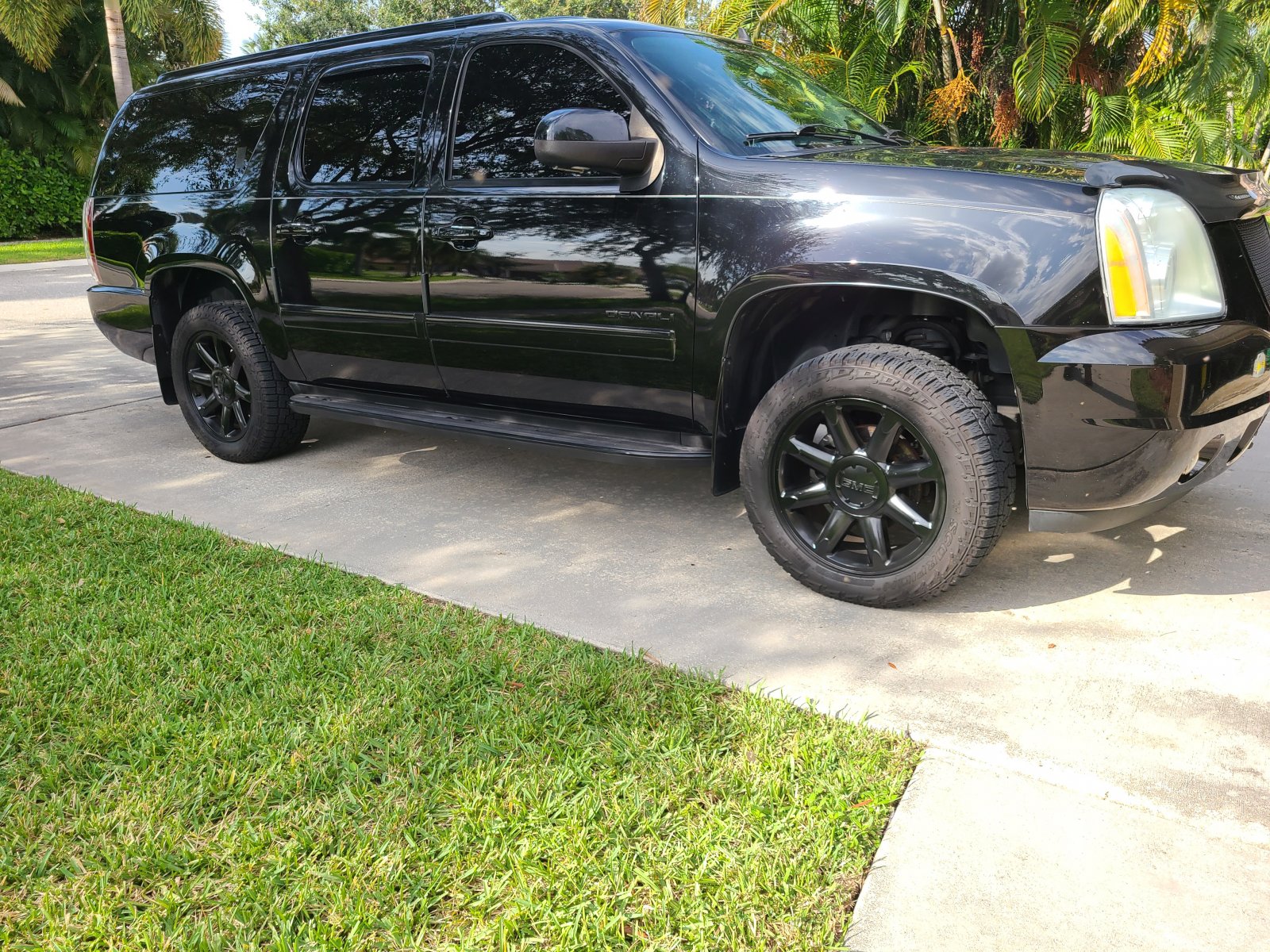

plattenator
Oct 22, 2021
2013 Yukon Xl Denali with a 2.5 inch in the front and 1 inch in the rear suspension max leveling kit. Tuned with long tube headers.
