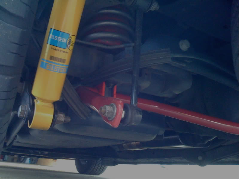

You need to extend the panhard bar to relocate the axle, then you can add some airlift 60769 helper bags to compensate for the big ass enclosure's weight. Can you get some pics of where it is rubbing the frame? Just the bracket with the bumpstop that hangs down or is it contacting something else? Looks good btw, the monsters aren't my cup of tea but the nittos are a badass tire :cheers:

Not my pic, did a quick image search and member VJR021's drop kit install showed up.
Here is where it is rubbing. Just the bracket.
I was told a set of air shocks would get me some lift maybe 1-1/2 - 2", but from your comment that may not be all I need. What do you think about the air shocks?

Get the helper bags and clearance that with a grinder, then spray it down with enamel paint or rubberized undercoating so it won't rust. I'd also recommend some bilstein 5100 front and rear shocks as the truck will ride considerably better...part #s are:
Front - BE5-C153-H0
Rear - BE5-D147-H0
