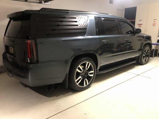

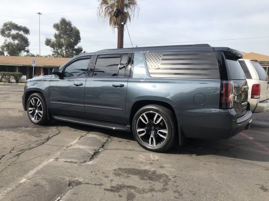

2019 Chevrolet Suburban Premier RST 6.2L 4x4
Suspension- McGaughys drop spindles, Belltech 3” drop kit in rear. Hotchkis F&R sway bars soon to replaced with Hellwig’s.
Performance- CAI intake, Corsa exhaust, JMS pedalmax soon to replaced with pedal commander.
Morimoto XB LED headlights
Anzo taillights
Diode Dynamics SS3 amber Max foglights.

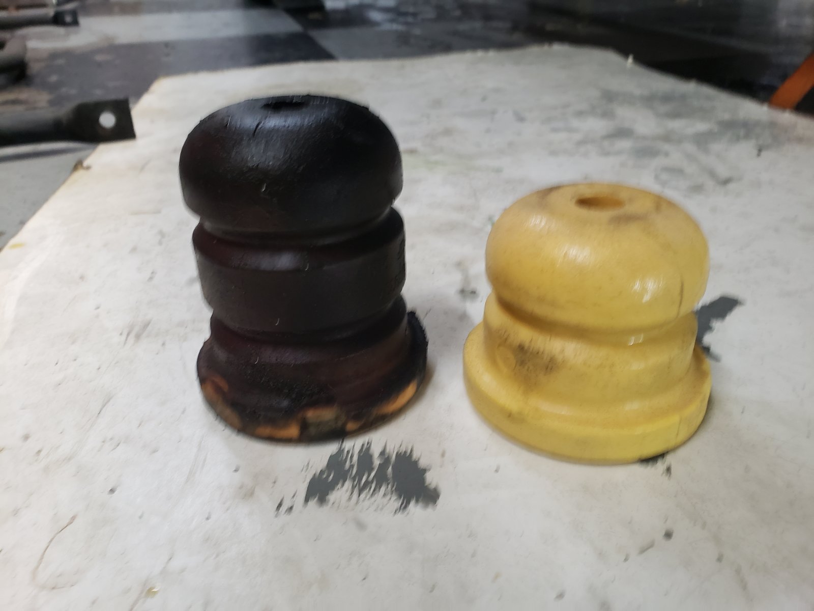

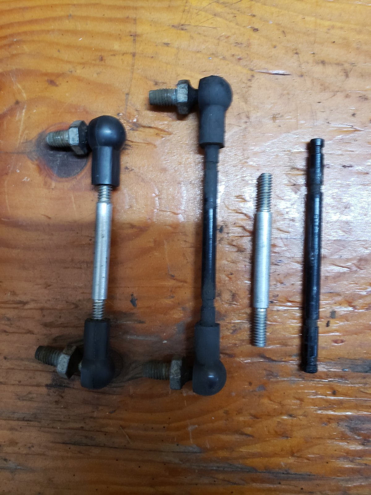

Did you just use springs to decrease the rear a few inches?
The BellTech kit for the rear comes with shock relocation brackets, shorter bump stops, springs for a 4" drop and 1" spacers if you want a 3" drop. Also comes with shorter rods for your leveling sensors.
Here is the install with the shock relocation bracket.

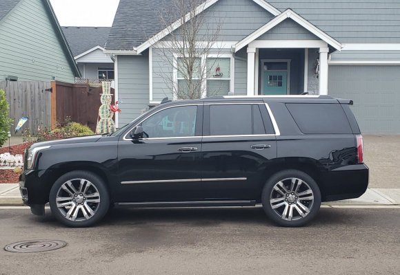

MrMonte I know you said you were running the factory 22's. Is that with the 285/45 R22 that come on the factory 22's as well? You have the stance I'm looking for with my new to me 2020 LS with the 285/45 R22'sPXL_20230115_013508138.jpg
MrMonte
Jun 23, 2022
57
123
MrMonte I know you said you were running the factory 22's. Is that with the 285/45 R22 that come on the factory 22's as well? You have the stance I'm looking for with my new to me 2020 LS with the 285/45 R22'sView attachment 390518
Yes, 285/45/22. The stance I ended up with is exactly what I was shooting for and very happy with the look and more so with the handling & great road manners. I'm on a roadtrip right now & did 800 miles today with some icey/snowy conditions without any issues.
