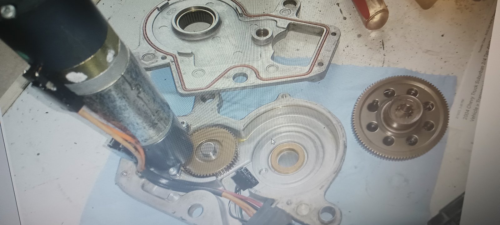

Did the GMT 900 have the AutoTrac NP 246 T-Case?
My 04 project suburban had that message when I bought it. It was stuck in 2wd.
I checked fuses and grounds, all good. The TC actuator wires were severed (maybe they got cought in the driveshaft?) Spliced them but still no go.
It turned out to the encoder motor range sensor (black wheel is the sensor, goes under the large gear with the holes.) $20 shipped from RockAuto. I tested the old one and resistance was erratic while turning the wheel, not linear. Problem solved.
