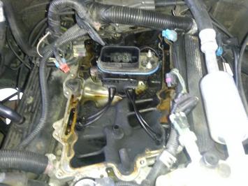

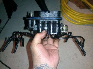

below are some pics with the upper plenum removed and the stock spider injectors. for those who dont know, the lower intake should be an aluminum finish in color, mine was black due to 204k miles of carbon deposits. needless to say, i have some intense seafoamin to do. in some parts of the lower intake, i scraped about 1/8" - 3/16" of caked up carbon. i cant imagin how my valves looks:jawdrop:
anyway on to the pics:

SunlitComet
OBS Jedi-Do Good
Sep 30, 2010
16,206
184
unknown at this time.
Looks just like mine. Your valves should be cleaner because by the time you get that far down the fuel is in there doing it detergent cleaning (hope you are using good fuel). The manifold was easy to clean but the plenum? Scrapers, brushes(including motorized)solvents, Dawn and finally Cascade Complete in the dishwasher (Don't knock it really does work) I was finally satisfied.

ryank99
Feb 16, 2011
56
central texas
didnt think of the dishwasher method....i use seafoam spray and let it soak for about 10 minutes, scrub it with an old toothbrush, added some elbow grease and ta-da - like new
