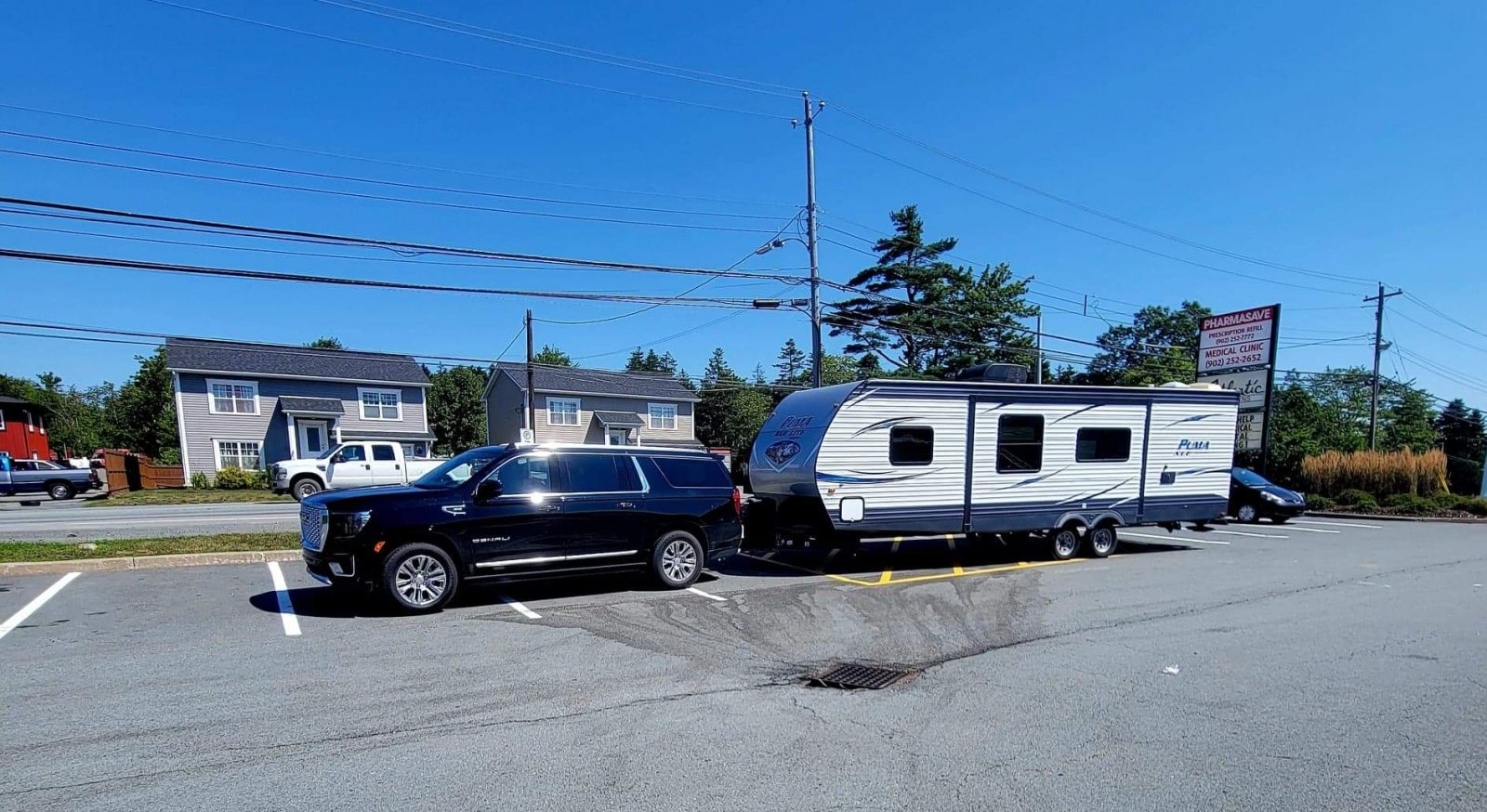

I have a ‘21 with the 3.0l and tow package. We pull a 24ft (28ft including tongue) weighing maybe 7k loaded. It pulls well but the wind kinda pulls you around. Biggest concern is the tongue weight. Wouldn’t be able to do it without a weight distributing hitch! Have to take it slow up hills. D8CCDB64-B9CE-4A3D-90A8-C1D4674CD998.jpeg
