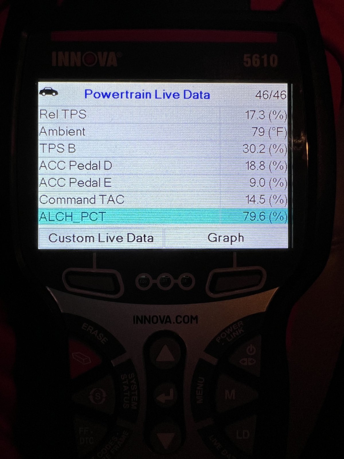

It’s steady at 43 which I see is normal for the LMG. Where can I see what numbers are normal for the other sensors? I think everything is normal other than the richness. I have an innova 5610 scanner. It reads everything.

What typically causes the alcohol content to be off? I never get E85 and my readings are frequently in the 10% range..

I think there may have been an updated calibration that was intended to correct that, but I'm not really sure.
