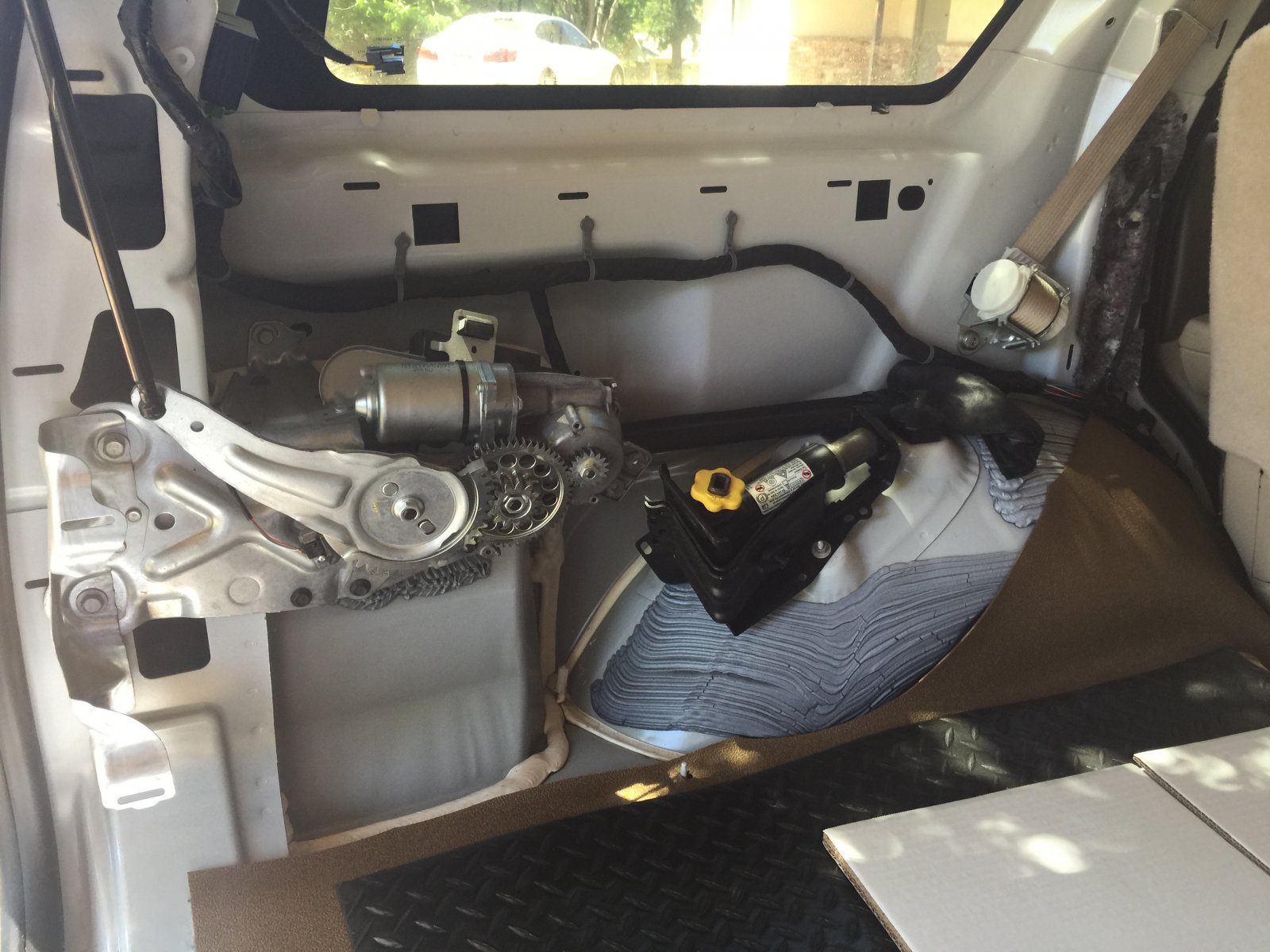

When I had my rear side panel off, it looked like the best place would be a small triangular section of floor behind the wheel well and jack. You should be able to reach down in there and see/feel it through the jack cover hole.(maybe with jack removed) Nearly the same area in that photo where the red wire is. I was planning to go closer to the wheel well though.. depends where you want your wire poking up. (I want it behind side panel)
What year is your rig? Is that motor a factory setup, or did you craft that for your rear hatch/window? Pardon my ignorance, but I'm new to Chevy Tahoes altogether! I am, however, on a crash course of learning, and you guys have been awesome thus far! Thank you all!
2012, it's the factory powered liftgate. I would have preferred manual, but the power is nice sometimes.
