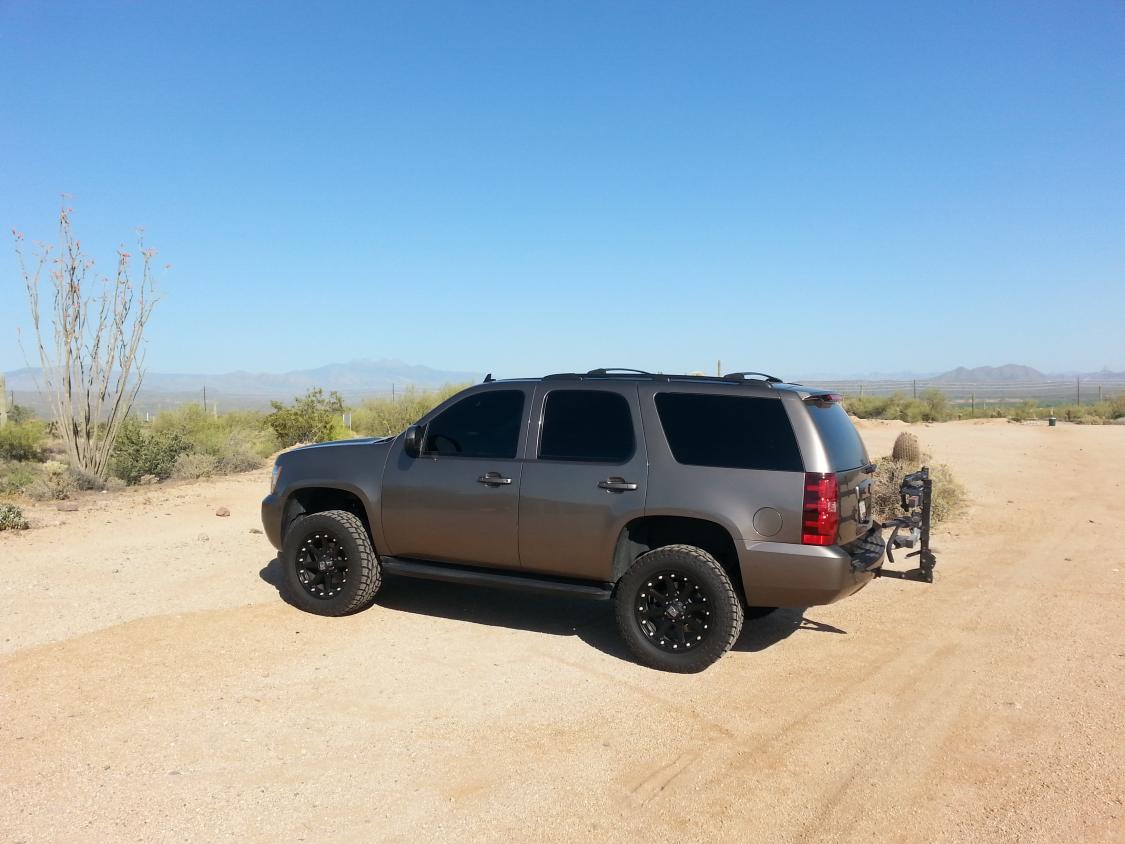

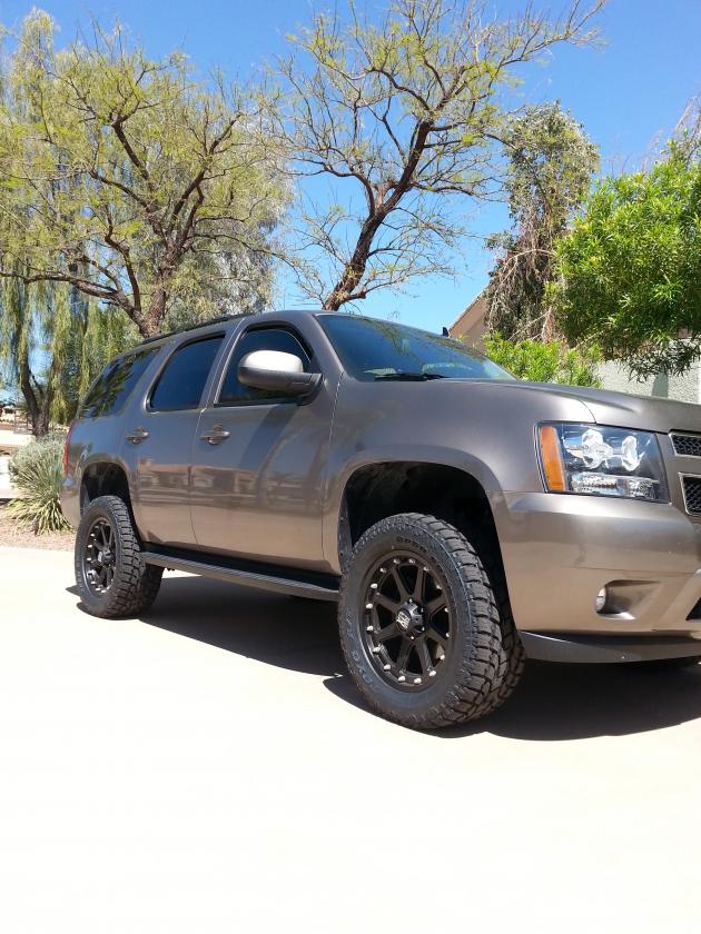

How about some pictures of the 3.5" lift with wheels and tires? I've already got the wheels, about to purchase the lift, and would like to see what you guys are running with this lift.

Here is mine with 305/55/20 Toyo AT2. 20x9 XD wheels at +18. No rubbing after minor trimming.
