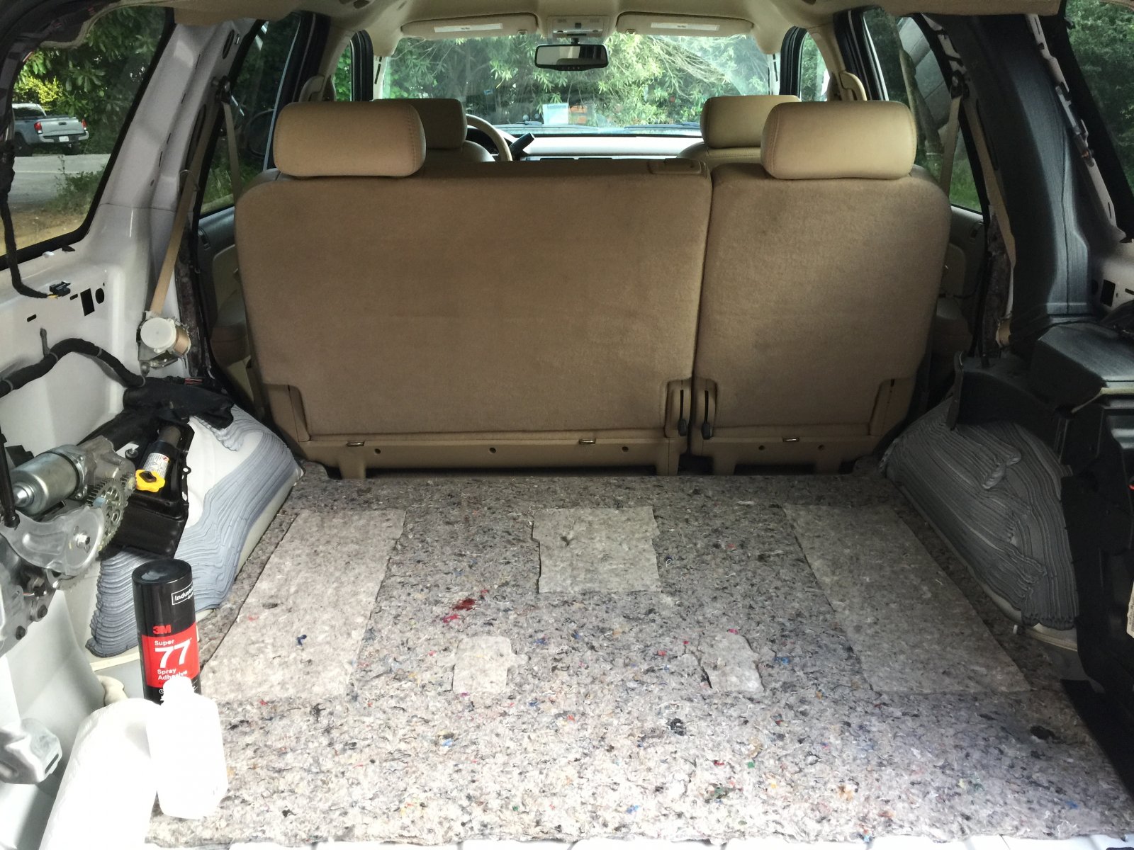

We took all the back seats out and built a wood platform.
Now we have a sedan delivery. And the space is big enough for a nice place to sleep in the National Forest campground. Pretty bear proof to boot.

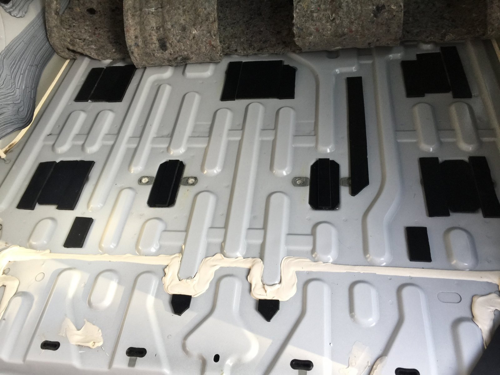

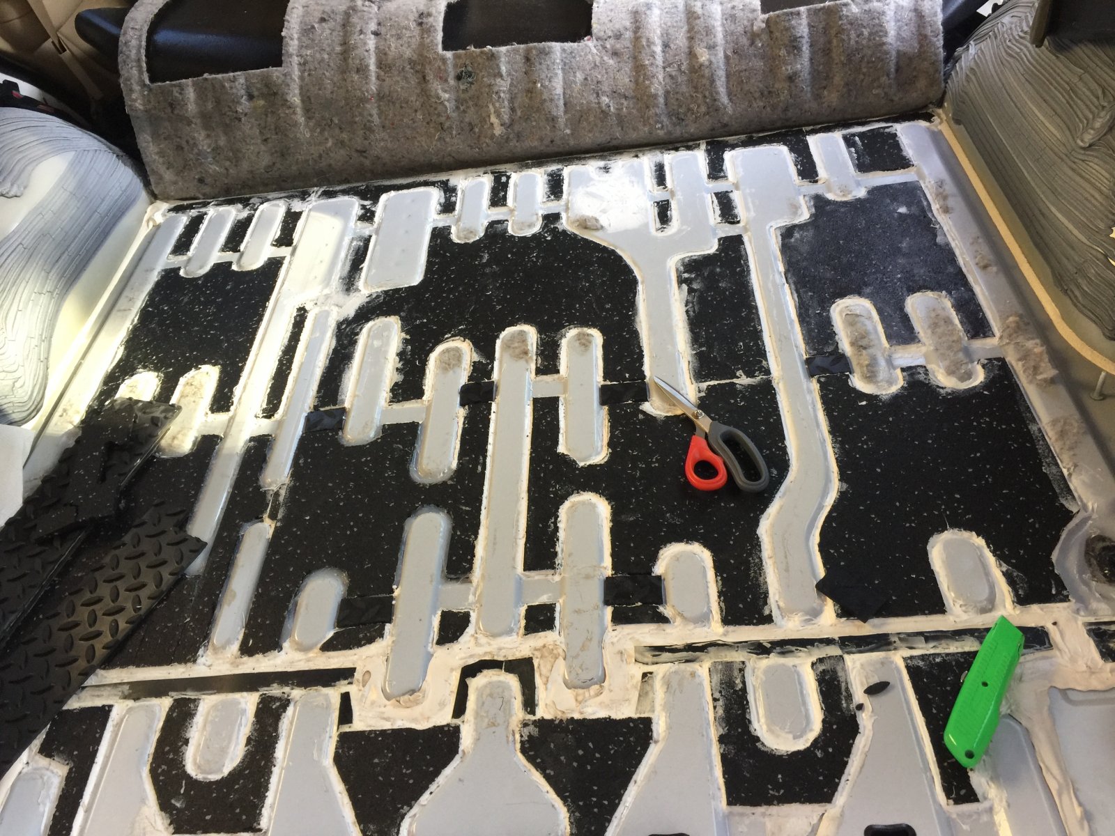

Maybe we need pictures of the area in question.
need to take out the bolts. maybe some silicone in the bolt holes.. dents are about 3/4" deep, rising bumps about 1/2" high. expanding foam is sounding pretty good.. maybe cut some rubber pieces to fill it..

Just get some more of that carpet padding. Cut pieces as needed to fit the holes. Maybe two or three layers. Cut one square and three rectangles to fill the deep holes, then another larger set, on top of those. Then one more larger to fill in and to level to the surface layer. I'd still go with a piece of plywood on top of the padding.

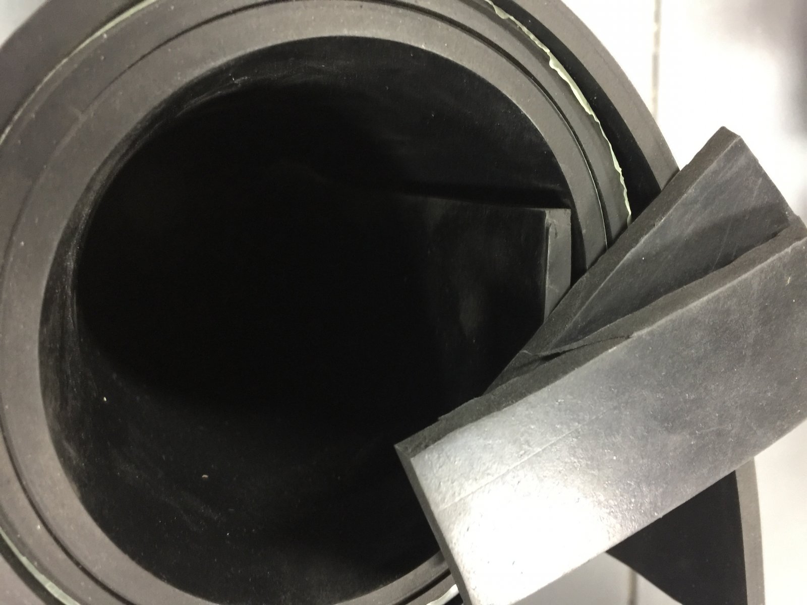

You mention rubber. Consider those anti-fatigue mats from Harbor Freight (and other places). They cut quite easily and are dense enough to prevent compaction over time.
I'd leave the bolts too. The padding will settle around them and you won't have a leak source from below.
That canned foam degrades and decays to crumbles and powder over time.

Not as big as i thought.. View attachment 398140
Expanding foam doesn't squish very well. It'll crumble if you happen to kneel or put weight on it and eventually turn into a yellow, crumbly mess that'll disperse all under the carpet.
I like the rubber idea. Cut some pieces to fit down in the lowest parts and larger pieces to cap that and cover the rest to bring it up the height of the bumps. Sandwich them with glue between each layer. For $10 at Harbor Freight, you can get plenty of material: https://www.harborfreight.com/4-pie...IFX9GyyDMnOOH_jzKjLKnuH5ZxqN-lehoCvjAQAvD_BwE
You can replace the bolts with set screws. Use a little thread sealer, maybe even a little BLUE thread locker to keep them in place.

Heck yea, good info. Don't need no crumbly foam. Will find some rubber and get to it! Thanks for all the help collective hive mind!
As for pouring some polyurethane, it would be stronger im sure, but that stuff usually stinks for a few days and im afraid ill make a mess somehow.. would lean that way more if i didnt think rubber will do the trick adequately..
For the bolts..Not sure if they sell set screws that big or I can cut a threaded rod into pieces maybe.. but then maybe ill just grind the bolts down to shallow domes..Heck if I can find plastic or rubber plugs, I might silicone them in place..and on the bottom..usually need a few plans, for when something doesnt go as planned!

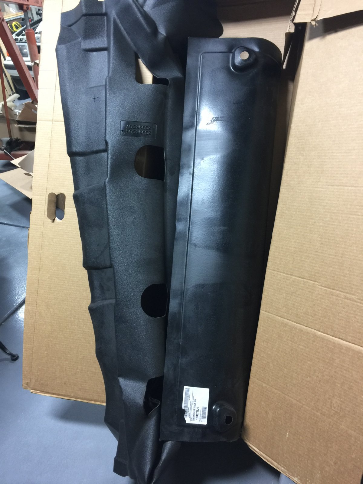

Also got this today..
I thought it was a top mat when i ordered it, guess ill have 2 layers of vinyl! Ill put the oem under the tan aftermarket..
