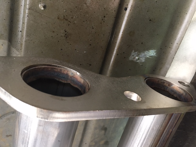

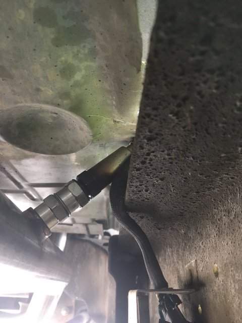

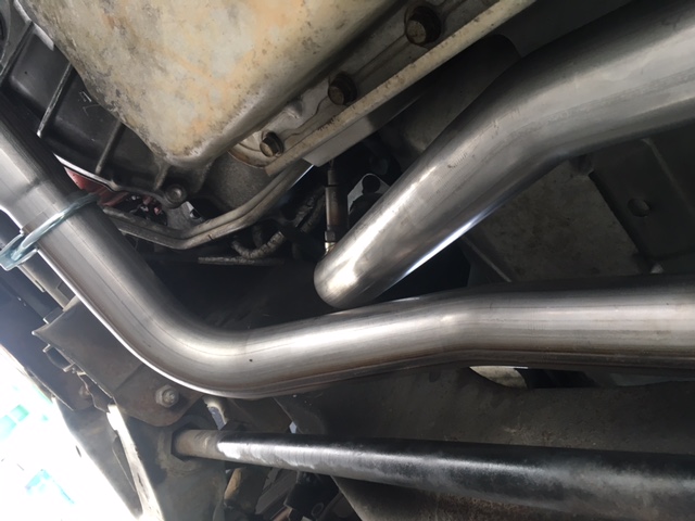

So I went ahead a removed both cats from my exhaust system and installed the Jegs Y pipe. I used the stacked spark plug arresters between the exhaust and the O2 sensors to fool the computer into thinking my cats were still there. However, my Tahoe is a California truck, so it has not 3 but 4 O2 sensors. My Y pipe only had 3 bungholes to plug in 3 O2 sensors. So now I have my 4th O2 sensor unplugged, and of course, the check engine light is on.
So has anyone ever “reflashed” your computer so you can delete the emmissions stuff? I live in a state with no smog requirements, but I have zero experience in this.
Talk to me Goose!
BTW, if anyone is looking to do this mod, its a pain in the a$$ and not as easy and straightforward as this video implies it is. Drilling out those 18mm spark plug arresters so they accept the O2 sensors took me several hours, as there is not alot of real estate (metal) left once you start boring/ hallowing them out, so its a painstakingly slow and tedious process.

I believe you can get those non-foulers on ebay already modded. Also, I think they have 90° ones for the tighter areas such as in your pic. Probably not as cheap as buying the non-foulers and drilling them yourself. But, what's your time and labor worth? I've seen small wads of stainless pot scrubber added between the two non-foulers to further filter the exhaust from the sensor. Keep this in mind if you get a catalyst inefficiency code.
Your '98 is OBD2, so it can be tuned by any shop worth their salt. Or, you can have someone (or a shop) weld another bung in the pipe for you to add that other sensor in. If you still have your original exhaust, you can cut the bung from it and weld that in. Adding that bung might be cheaper than getting it tuned, or maybe not. If you get it tuned, you could have some other items modified if you want such as top speed limiter raised or "removed", speedometer adjusted if you're running (and keeping) a non-original tire size, shift points and firmness altered, etc.
