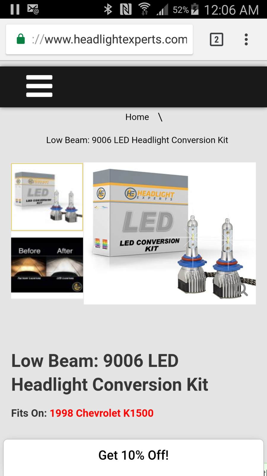

I want to keep the stock lights fixtures and wire some hid or led or something into them. Anyone done it?
Im thinking something like this

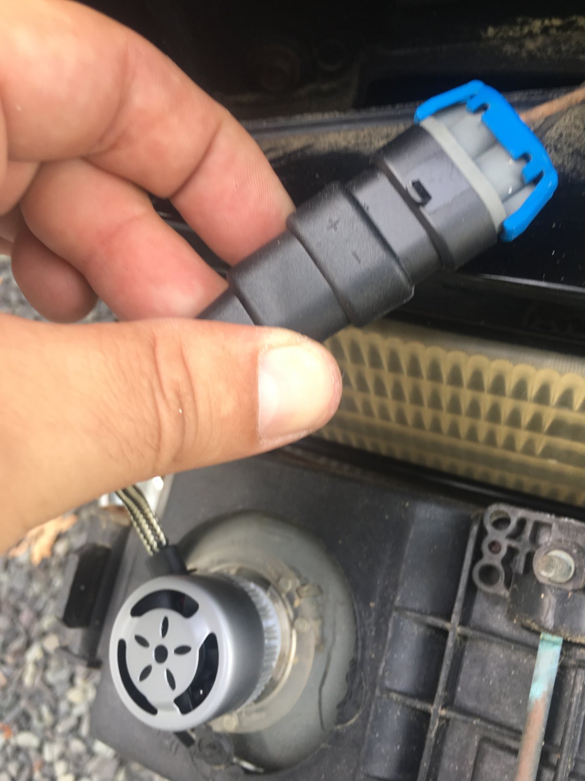

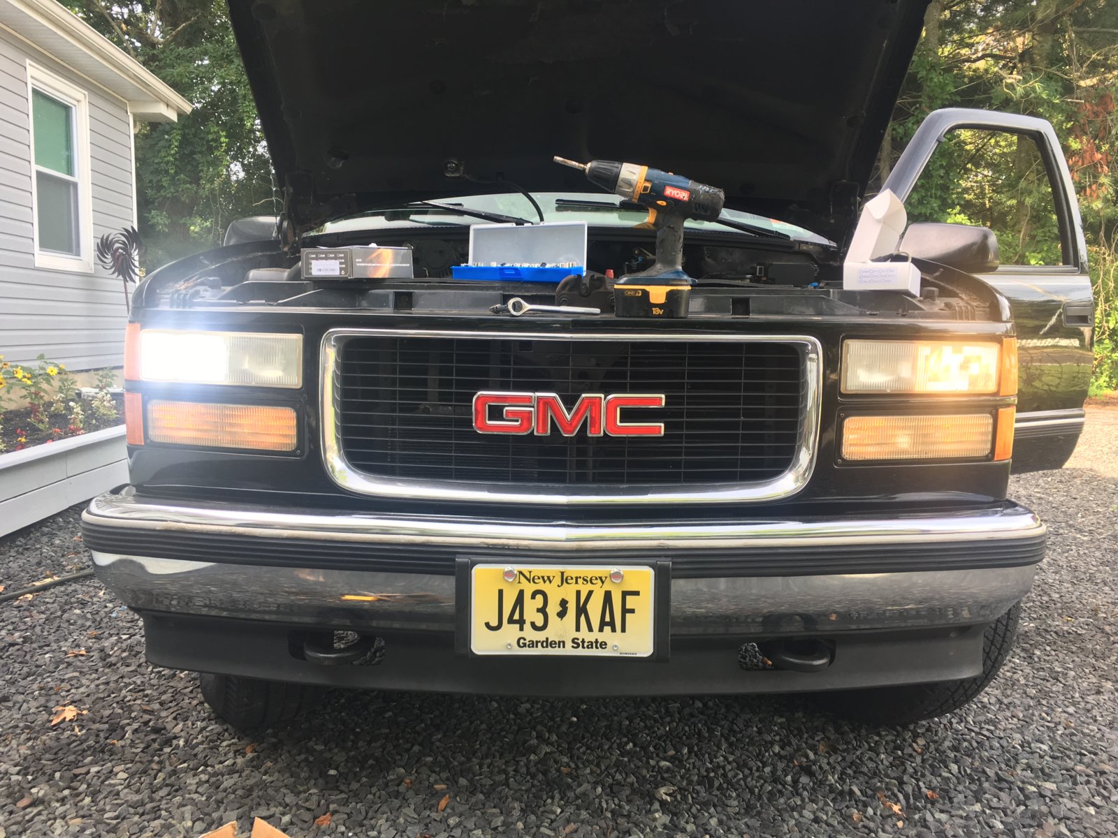

I just did this mod on the Low and High Beams.
Then I added an OEM fog light switch from a 99 Suburban Classic, and can switch on both lights at the same time.
Here’s a shot of the easy connection and one comparing the OEM style bulbs with the LEDs
HUGE improvement.

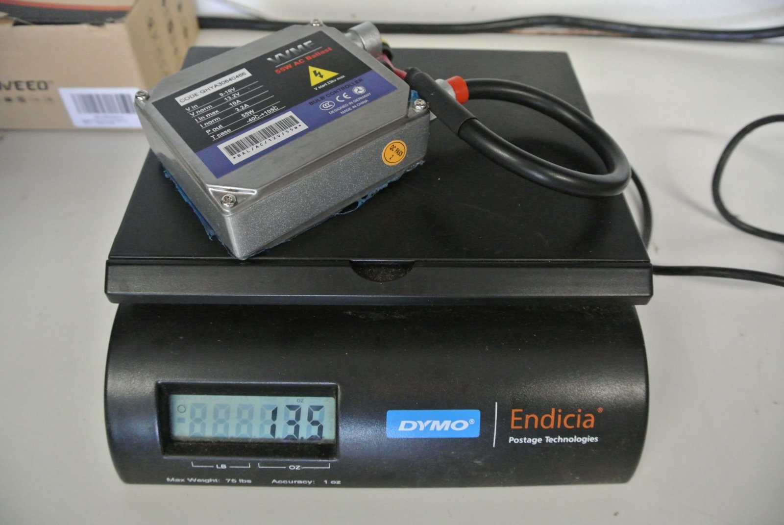

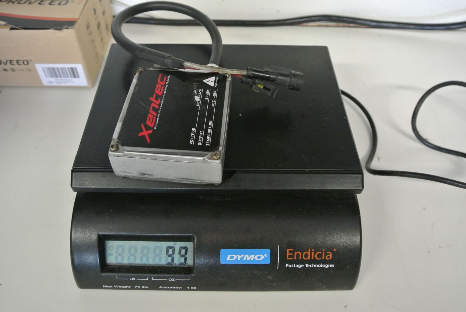

I've ran HID's for the last almost 20 years, personal preference. if you get some old school ballast's there pretty reliable the new stuff is garbage
23,411
34,035
after being around the block on HID's I go by the ballast weight, the better ones are heavier like these vvme, the vvme is 13.5oz, versus the newer xentech which is only 9.9oz (it's probably a knock off) even though they swore it was genuine, some of the lightweight ballast don't last a month or two but the better ones will last for years and years if you mount them properly so there not exposed to rain at all.
