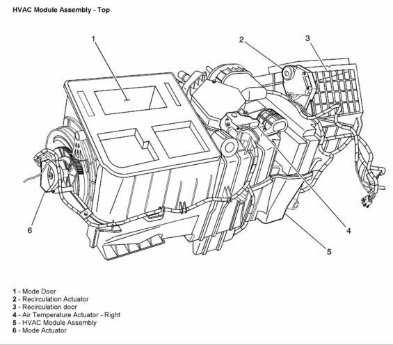

03 tahoe LT. Can anybody tell me or give me a schematic with the location of the recirclatory actuator location. I understand its on the top of the heater/AC box in the dash.
Do you get to it from inside the cab or at the windsheild cowl?
Thanks, Rob

How's this
