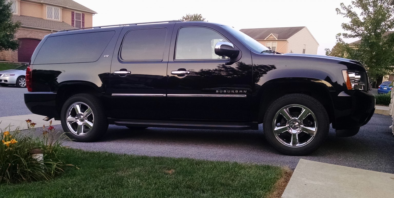

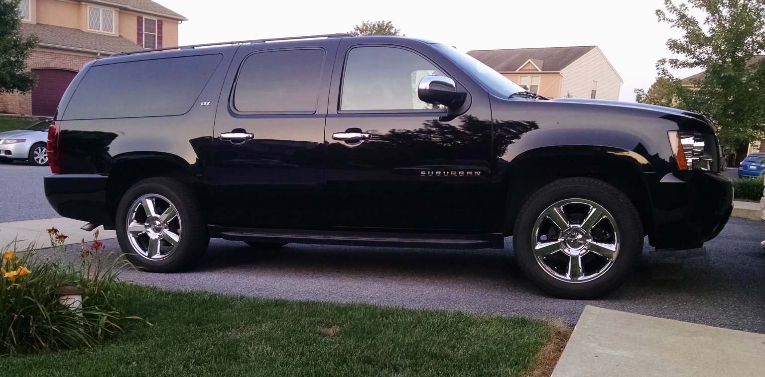

Has anyone reattached the factory side molding? I want to remove mine but if I don't like it I want to reinstall. What size tape did you use? I did a rough photoshop to see the outcome.

Next free weekend I'm going to remove it, if I wouldn't like it I'm going to go with the 2015 style since its smaller. I have issues with the current moldings holding water and drip marks building up on the paint from the hard water around here.
