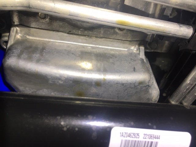

I'm afraid my rear main seal is leaking as well. 2022 Tahoe Z716.2 with 2100 miles. I visited my local service department this morning and starting telling them make/model etc and they assumed I was getting ready to say my lifters failed. I would rather have the lifters replaced vs what they will need to do to replace the rear main seal. Did they end up pulling your motor or the trans? IMG_2061.JPG
