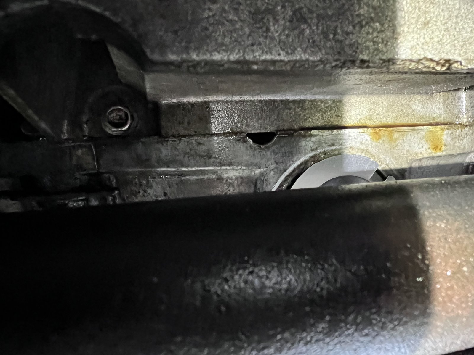

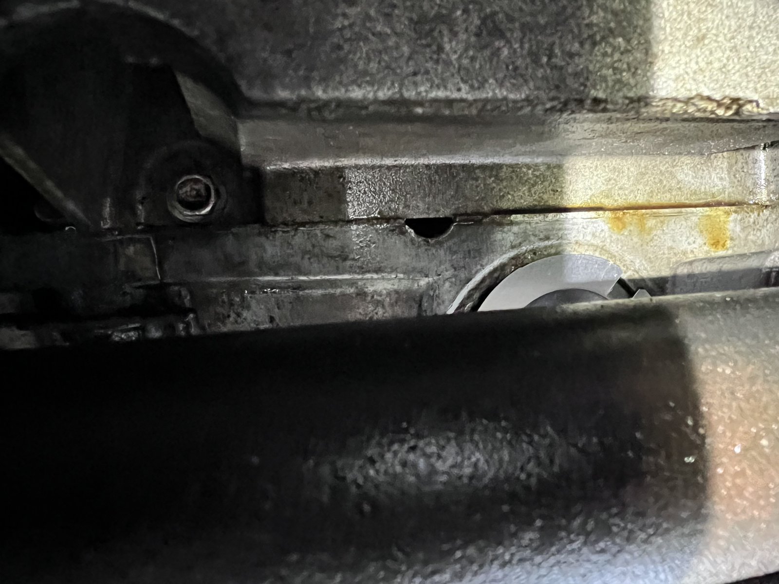

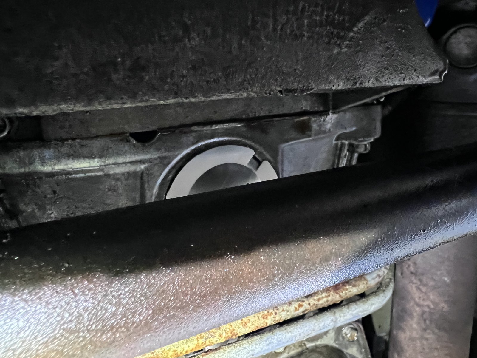

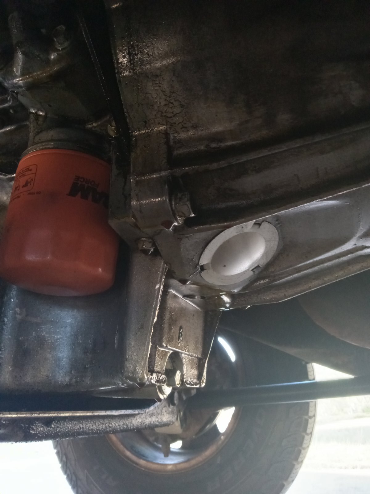

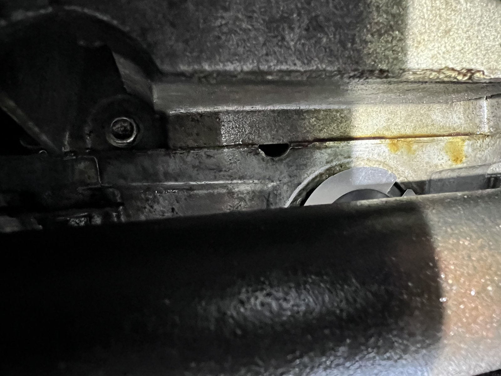

Been putting off looking into what causes oil drips on the driveway for the winter and it’s finally warming up here on Detroit border in Canada, nice n sunny by the Lake.
So far I’ve figured the drops happen more often when i park it uphill with engine and when parked engine downhill, only 1 drop after long drives.
Haven’t had to add any oil between oil changes yet.
Cleaned her up underneath, put front wheel on ramps and kept running until fully warmed up.
Finally was able to locate where the oil is accumulating, wiped and few minutes later it’s in the same spot again.
Is this a precise location for the rear main seal or there is something else in that part that would leak?
Surprisingly i had taken off the cover plate few times before and everything looked dry inside.
Anyway, pics attached, hopefully someone can confirm!
And if it’s rear main, what else would you recommend getting replaced while the tranny is out? Oil pan and pickup tube while got access? Or just do the seal.
Will not be doing it myself, doing it at home on ramps sounds like pita, will have a neighbor take it to his shop.

That could be the rear main or the oil pan. Since you can do them separate, I recommend starting with the oil pan since it is easier (cheaper if you're paying a shop).
B-train
Sep 12, 2022
991
1,377
Agreed. I went down the cheaper road myself only to find out it was a RMS the whole time. Hopefully you get lucky and its not. It's a PITA job to do the RMS, so mine just parks on cardboard until I decide if it's worth putting that kind of money into.

Thanks folks, i decided not to risk it with cheaper path as i'll end up paying more doing them separately of RMS is the leak :)
The car is more like a "toy i always wanted" rather than beater, so i don't mind throwing some money to make it look and drive nice!
Ordered oil pan, picktup tube, filter and neighbor is going to take care of RMS with both rear seals and new cover.
Let's make it nice and tidy!

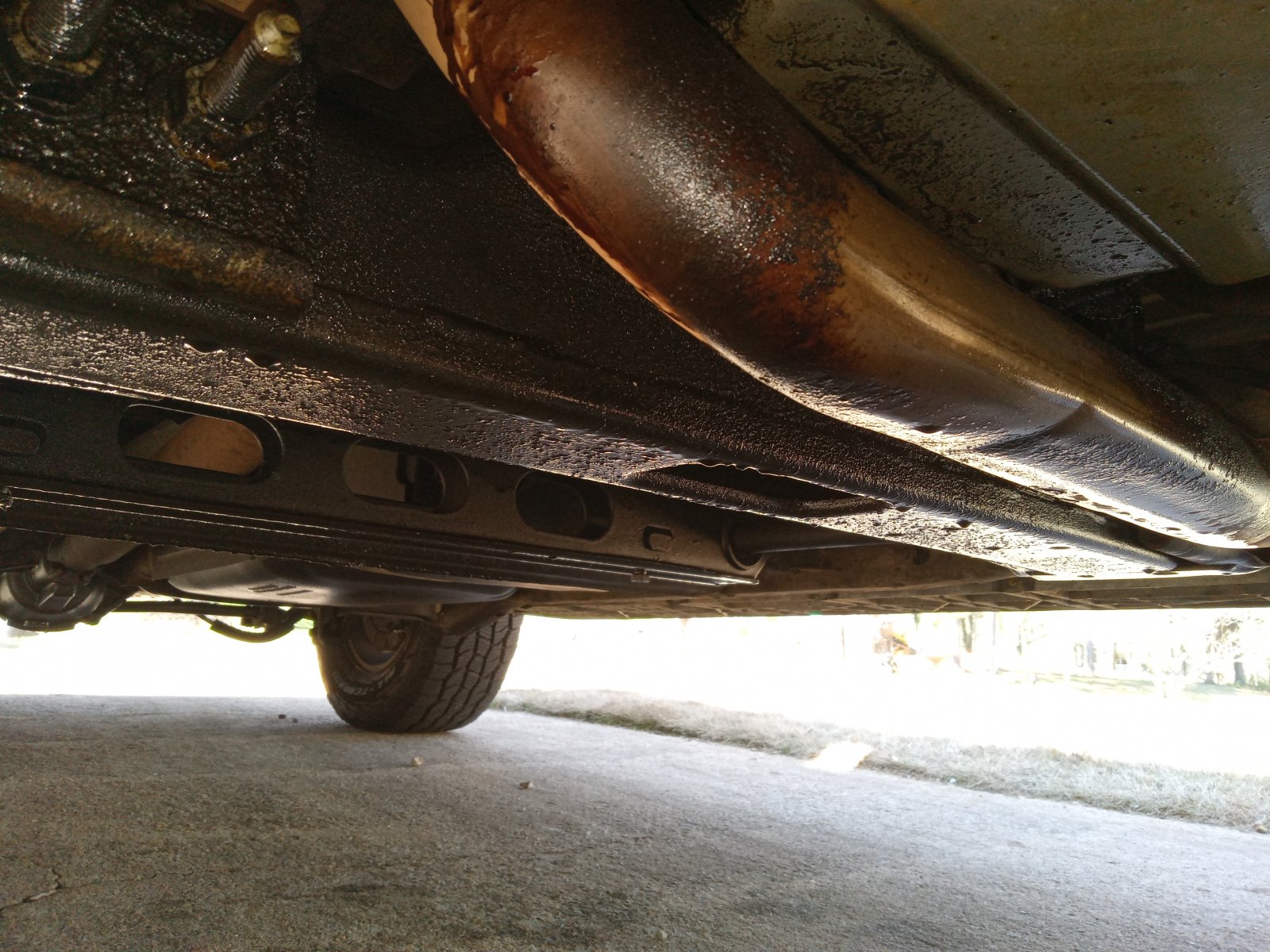

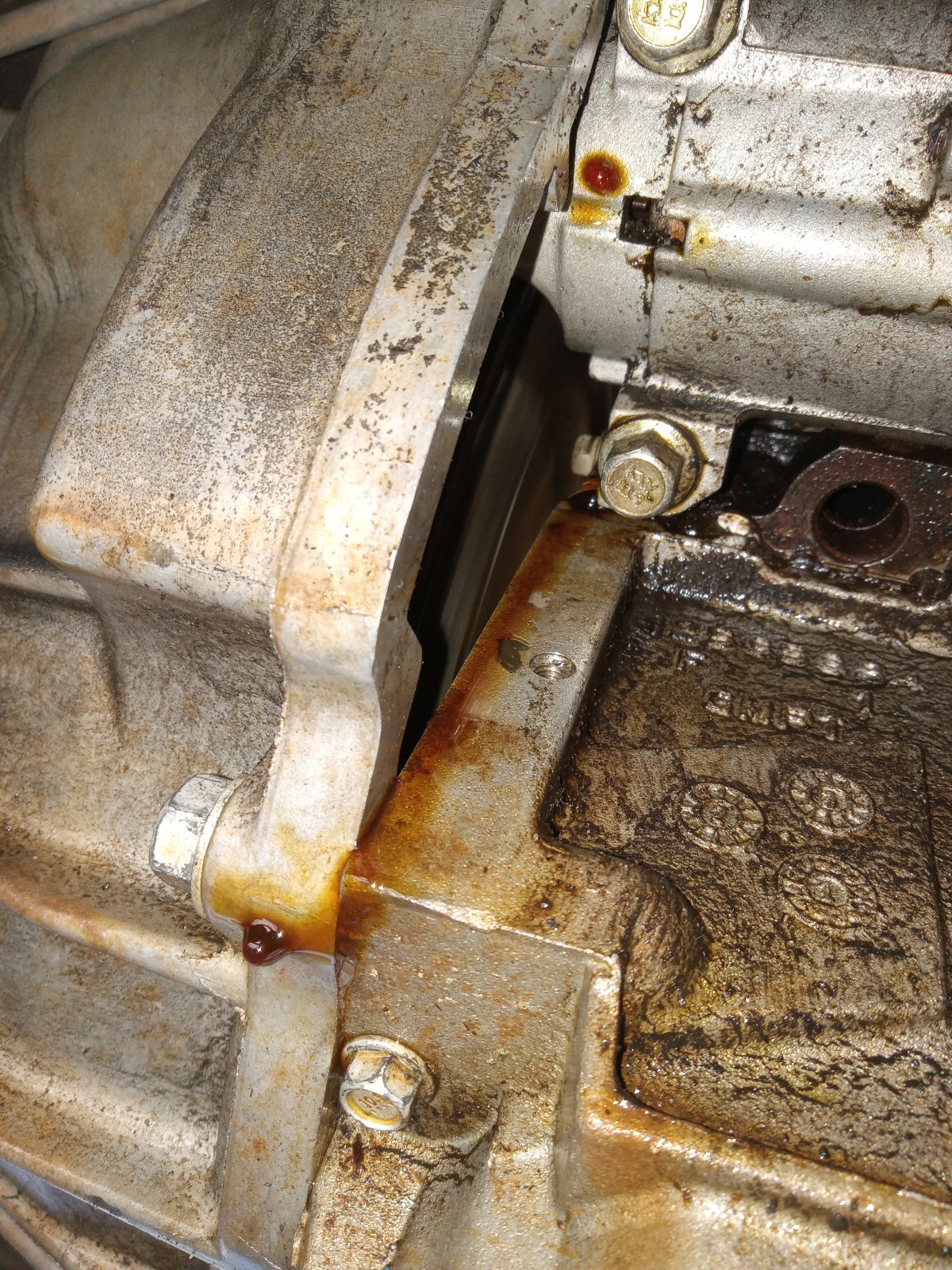

My 02 Tahoe (285K mi) rains oil. This thread affirms my suspicion of the RMS. With oil at $8 a qt, I need to do something about it soon. New to Atlanta area and few tools, unfortunately. Anyone know anyone in the area who'll rent me their shop stall or garage (with tools)??
I'm also concerned about the oil flashing into a fire as it smolders on the exhaust crossover section. Has anyone seen this happen? Should I install a heat wrap on this section of exhaust until I make the needed repair?

For anyone wondering - doing rms with oil pan at the same time was a right call.
My mechanic said both were leaking once apart, rms cover had loose bolts.
Should be picking up her today or tomorrow.
Replaced: rms with cover plate, oil pan with all parts, oil pickup gasket, tranny cooler lines
