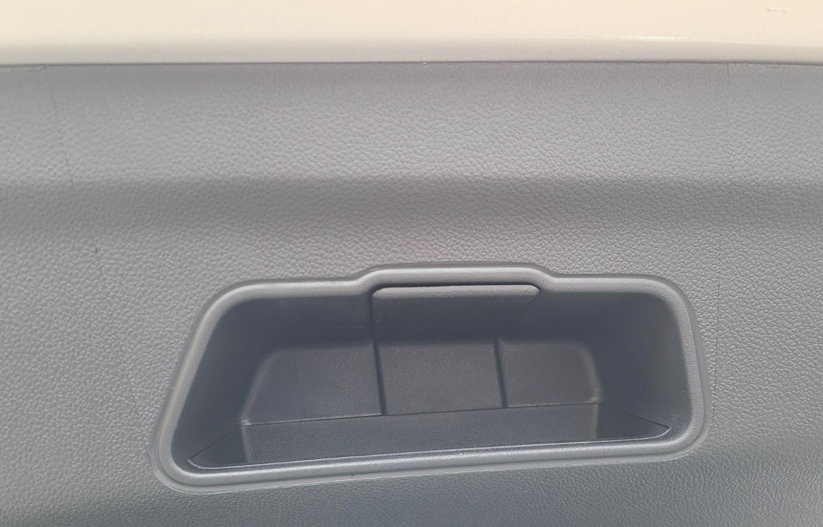

Got in a rear ended yesterday during stop and go traffic on my brand new Yukon (100mi on odometer) and I noticed there are fracture lines around the hatch open button area. Could anyone confirm that they don’t have it?

Those are called witness lines. The injection mold for that part has an “insert” which they swap out of the tool to mold the version without the power liftgate. The lines show up at the edges of the insert.
Don’t worry there is nothing structurally wrong with the plastic. It’s just cosmetic.

I think the panel can physically separate there to facilitate repair of the switch if necessary Vs removing the whole tailgate panel. No big deal at all….

highly doubtful....if that was the case there would be a clip/bolt/screw in place to do such a thing

I design injection molded plastic parts for a living. These are 100% witness lines from an insert in a tool. Trust me.
I guess why do they design such that the witness lines are in such a obvious place?

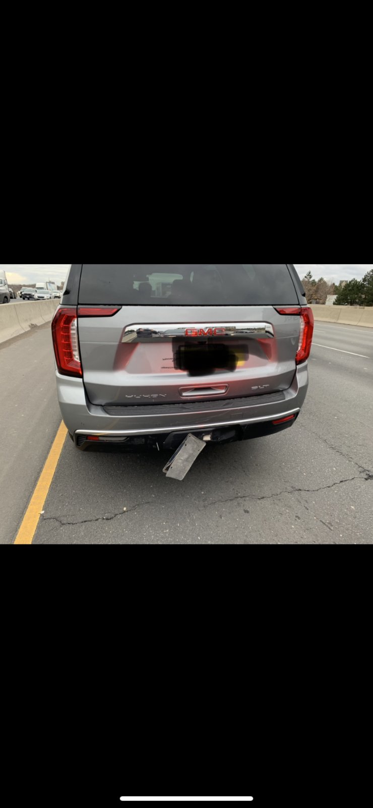

How hard were you hit? Any photo of your overall rear end showing the area hit?

Was hit when I was fully stopped during a stop and go traffic flow. Yukon had 100mi on it and only was 10days old

Was hit when I was fully stopped during a stop and go traffic flow. Yukon had 100mi on it and only was 10days old View attachment 386079
Ouch.
To be honest, I can’t see much damage from your photo. The other guy definitely got the worse end of the deal.
Looking at the various lines on the liftgate and the corresponding lines on the corners, it doesn’t appear to my untrained eye that anything is really out of alignment. At least not enough, in my opinion, to cause the interior trim pieces to break, but I could be wrong. The various photos of the interior trim pieces appear to me to show factory edges on the pieces and not cracks. It may have popped some mounting tabs on the backside to cause the piece to be able to flex a little.
Have you had an insurance adjuster or body shop look at it yet?
