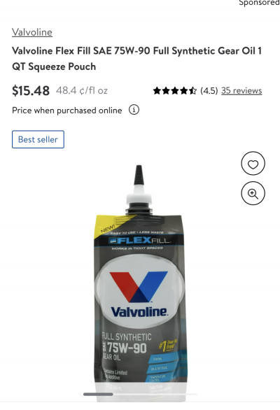

I replaced the rear differential gear oil last weekend using 75w90; it took right at 3qts. The old oil looked very good for the miles (at least 170k miles); the differential was like new with only a very small amount of metal filings on the magnet (like putty in fact). Got it cleaned out and put a new gasket and filled it up. That’s when I noticed that the new gear oil had the limited slip additive in it. So after a mild freak out I read on the bottle that it could be used on either limited slip or open slip differentials.
Is that true or do I need to drain and flush the differential and replace the oil (w/o the additive this time)?

Well, what brand and part number did you use?

The limited slip additive is important for the clutch in the differential, if a certain type of locking differential is installed there. The locking differential also has normal gears and bearings like a normal differential. If the Limited Slip additive does not interfere with these gears and bearings there, this will not be a problem with your differential either.
In other words, it is bad to operate a differential that requires limited slip without this additive, but it should not be a problem, to operate a normal differential, with a limited slip additive, as far if the type of oil is correct and has the correct viscosity.
