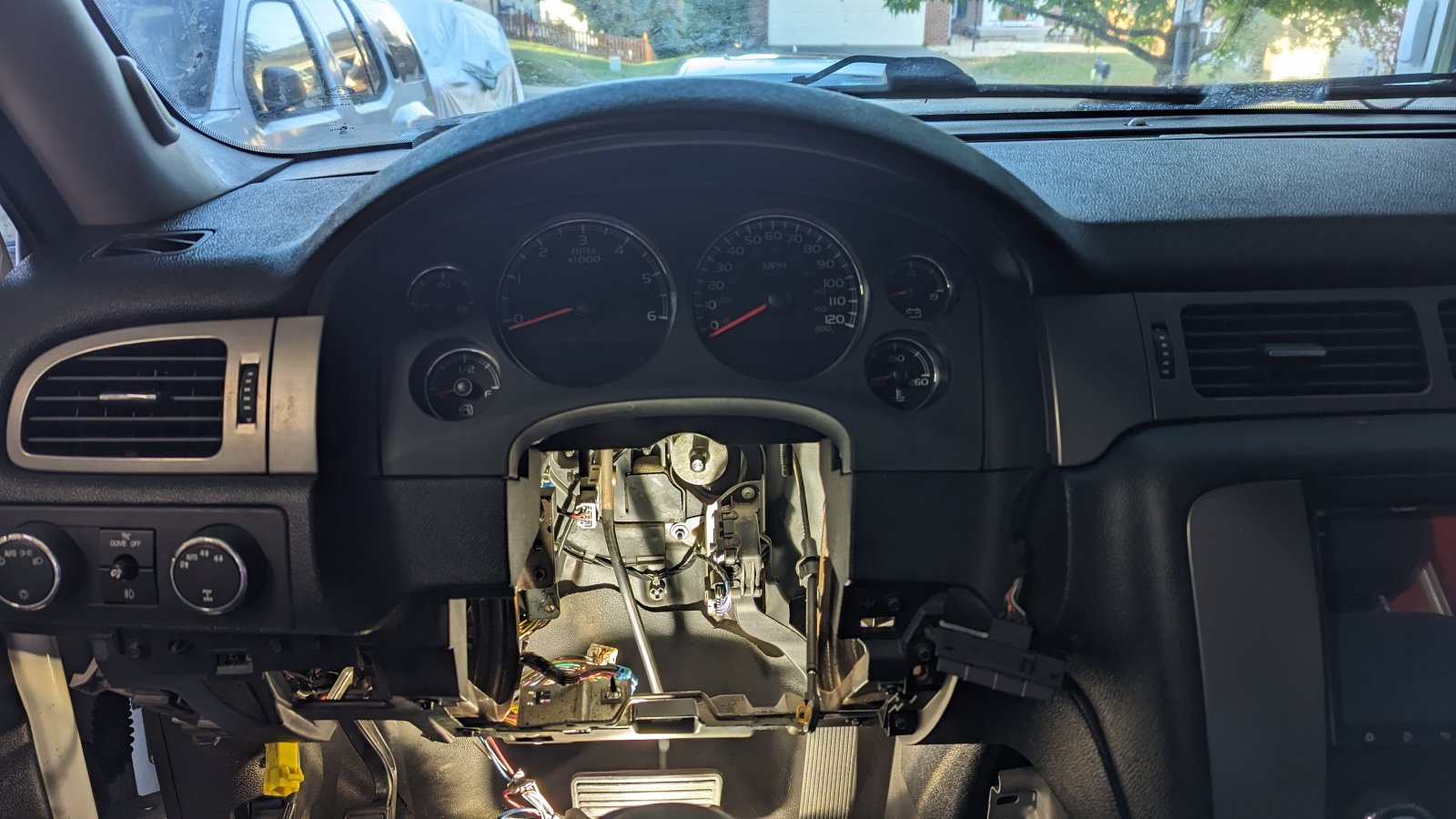

For anyone else who might have issues with the door locks not opening, mine seems to be the actuator (at least the driver's side). There is a lot of dust on the inside of the doors, and I imagine with the dust (and the age) all of the actuators are shot.
That was not the only thing that was shot; any guesses here as to what also got replaced? :rolleyes:

what was wrong with the steering column? I take it you didn't get lucky and find a matching trim piece for the dic switch?
Steering position sensor was bad. I was getting a Stabilitrak warning every time I moved the wheel left or right. Not sure if anyone has mentioned it on this forum but this is the part# that works:
As for the dic switch trim, yep I couldn't find a matching piece (for a reasonable price). I ended up getting a wood grain piece that I am going to vinyl wrap.
it's not a real common part to fail but it happens, luckily using a scanner to get the code usually points you right at the problem
