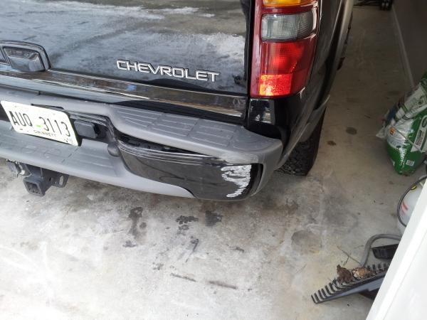

My rear bumper managed to find a retaining wall last week and now I am trying to find the best way to fix it. GM wants $700 plus just for the bumper and the right side plastic step pad is another $150. Needless to say I am not planning on going with a factory bumper and am trying to find an aftermarket one that is not a POS. There are so many out there but I was hoping someone here may have purchased one before and can chime in.
I also stopped by a small body shop today who had repainted my front end last year and they seemed to think they could straighten out the bumper. They quoted me $450 for everything minus the plastic. I am hesitant to do this because I can't imagine it coming out looking right.

Doesn't look like your plastic step piece is brokn, looks like it just popped out it clips to the bumber. I'd try removing the plastic piece take your body tool aka a hammer push bumper back down and into shape snap plastic back on. Then might have to paint bumper to get rid of scratches and what not. I say this cause I had a similar problem with my nali rear bumper, parking lots suck, anyways plastic piece is retarded money ended up not being broken just a tab or two underneath. Used a hammer on bumper straightned it out looks great!

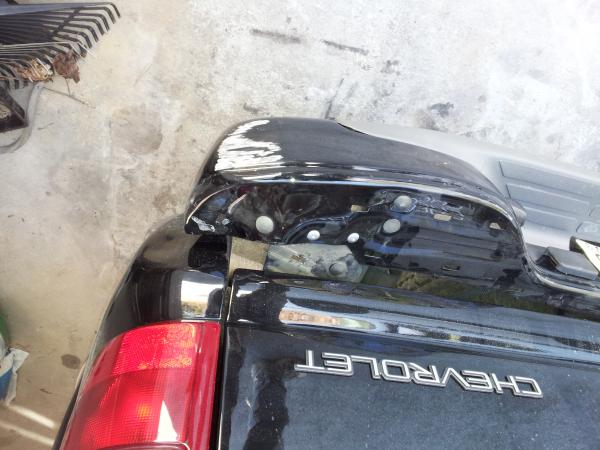

Already took the plastic pad off and it could be saved but it does have a big scrape on the corner. With the pad off you can really see how bad the bumper and the right mounting bracket are damaged. It's hard to tell but the bumper is also dented where the scrape is.
Don't know why this pic is upside down but you get the idea.

Did the bumper get into the Rt quarter panel? I would stay away from the shop that quoted $450 that sounds like a hack job...

I appreciate all of the response guys. It did unfortunately hit the quarter panel but it only caused a minor ding which I am not even considering getting fixed. I too am concerned with letting someone repair my bumper but they seemed confident that I would be happy with the result. The vinyl idea is interesting but I think I would rather it be painted.

The plastic pads are held in place with tabs that stick out from the bottom. I would imagine the best way to remove it is to be able to push on the tabs from the underside of the bumper and work them out slowly. That's what I plan to do to remove my other two. If you just pry from the top you will most likely damage some of the tabs. As you can see from my first pic the step pad was pulled from the bumper in the accident and a few of the tabs were damaged.
