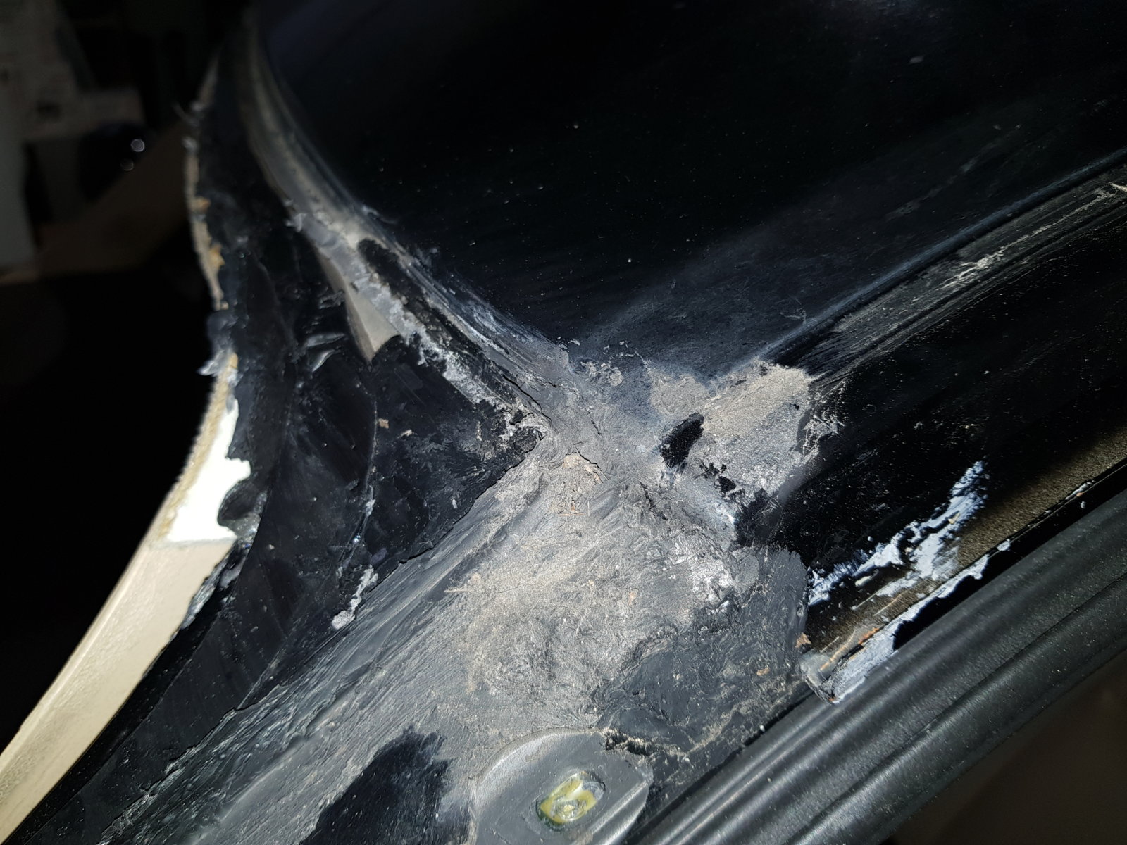

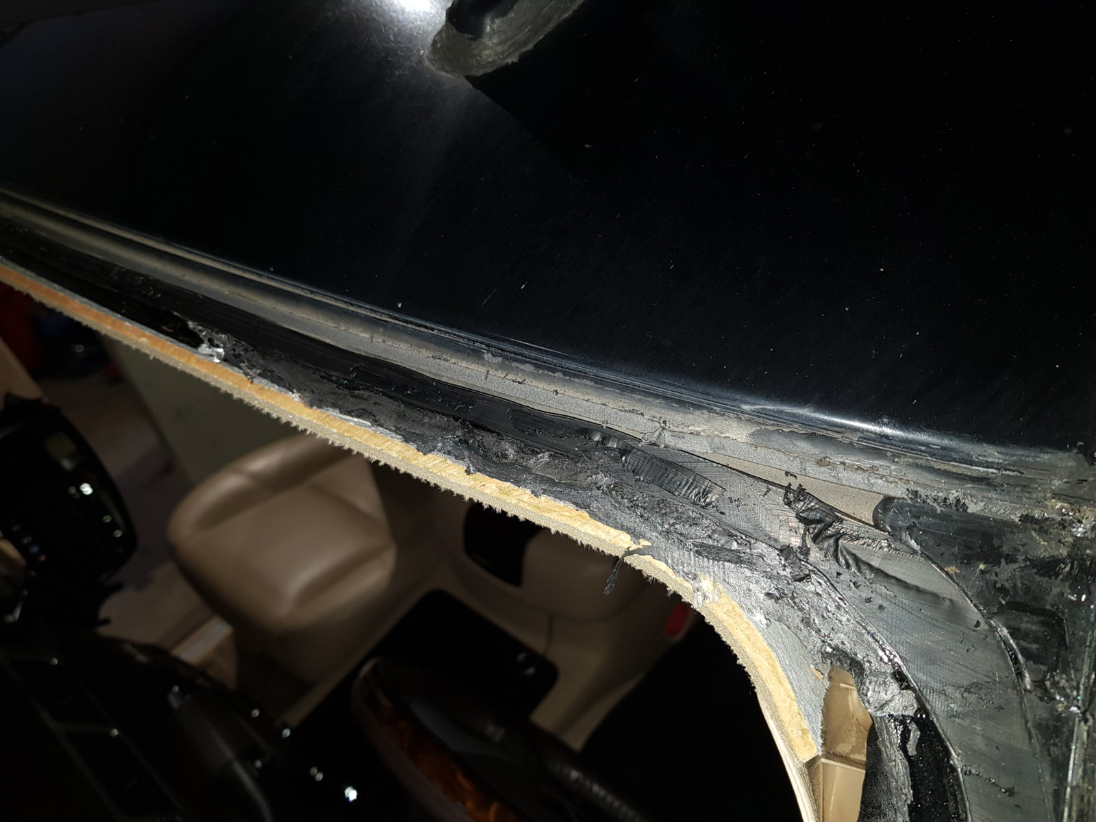

Ok so I wanted to update this thread.
In between then and now, my windshield got badly cracked and required replacing. Since I was at it, when the shop removed the old windshield, I got pictures of exactly where the leakage was occurring in my case. Click each picture for the full image.
20190123_154130.jpg 20190123_154135.jpg 20190123_154158.jpg 20190123_154151.jpg 20190123_154142.jpg
Basically, what you see in the corner was my repair. That's where I put the 3M Windo-weld into place, and it settled into the exact shape of the corner of the windshield. It is my belief that the crack/weld joint leak is underneath there, as it completely stopped leaking after that.
No matter, after the windshield replacement, there is no leak at all. It's pouring rain right now and has been all night; I just went and checked and the interior is bone dry.
Hope this helps.
