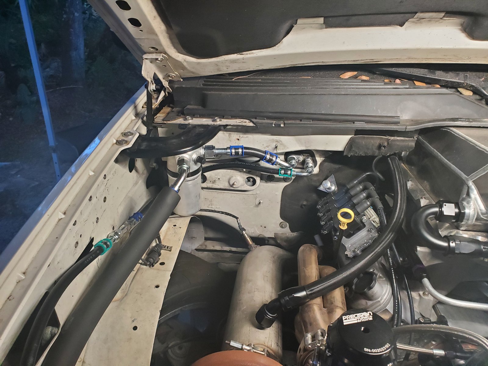

    well gents... i think i've got the cooling system whooped
    soo i ordered that evans coolant, a new expansion tank, some crap to mess with the steam ports. only the coolant came in so far but i figured before i dumped the expensive coolant in and still had problems, maybe i should just try some cheap 50/50 mix stuff to see if a higher boiling point would help.
    grabbed 2 cheap gallons, emptied all the water out threw it in. I had some 1/8 npt holes that were where the old steam vents went to. well i just put a couple pushlok fittings in them and made a little loop from 1/4 poly tube to seal them up (didnt have 1/8 plugs). just for the hell of it i messed with that a little just trying to make sure everything was bled out of the block and after messing with it noticed it would leak. took that junk out and put some plugs in. then i also put in a temp hose from the radiator upper most port to my existing expansion tank, but kept it below the coolant level so it could bleed air out and just suck coolant if it wanted to. just drilled a hole in the bottom of it and threw in a fitting since im swapping it out anyway.
    threw the cheap 50/50 in there fired it up, let it idle a bit to get the temp up. got up to like 155 after a few minutes . took it out and ran it for over n hour and the hottest it got was like 184* wanted to settle between 170-175* cruising. maybe a touch on the cool side, but not really concerned with mpg n crap. was also "only" about 80* out so a few degrees cooler than i have been dealing with.
