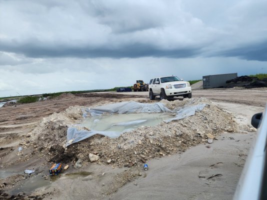

Pick up that beer can trash.
bruh you dont even know, shit gets me pissed seeing all trash these ***** leave lying around.
sometimes its cause of shit just being windy but usually just stupid ****** workers
we ***** every meeting and cleaning up, contractor will get a couple laborers like once a month and do it then, its annoying af
