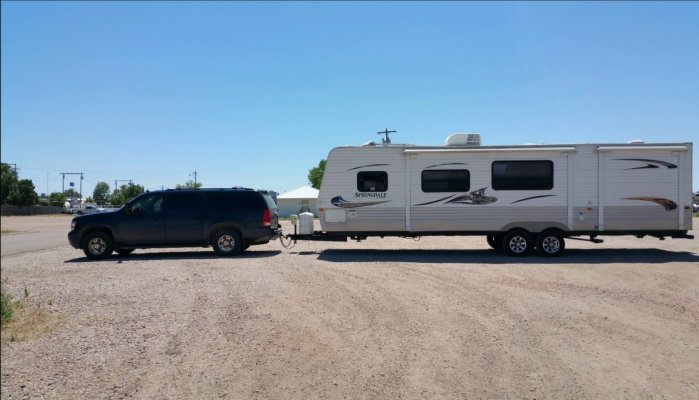

I tow an 8600-lb trailer with my Suburban. It's been through the Eisenhower Tunnel (11,000') and over Powder River Pass (9666') multiple times.
Parked at Wall Drug:
