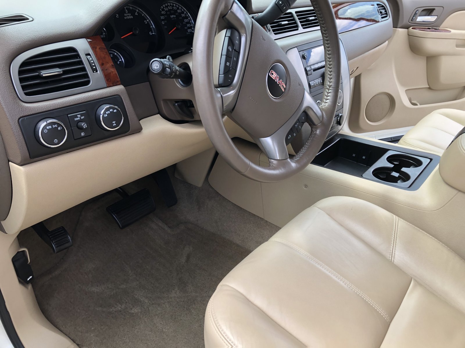

Thanks for the info. It does not have that code from the rpo plate the dealer sent me. But as long as it has the higher towing capacity then an aftermarket brake controller is too easy. As far as my screen name, Couldn’t think of a good name at the time. But definitely took care of a bunch of Apache pilots, crew chiefs etc in Afghanistan. Now I’m a medic with a infantry unit and a cardiac RN on the civilian side. Here’s a pic of the rpo plate and dash without the brake controller.

Thanks for the info. It appears it has the higher towing package but no integrated brake controller. I added a pic of both the dash and the rpo plate.

View attachment 254196 View attachment 254195 Thanks for the info. It does not have that code from the rpo plate the dealer sent me. But as long as it has the higher towing capacity then an aftermarket brake controller is too easy. As far as my screen name, Couldn’t think of a good name at the time. But definitely took care of a bunch of Apache pilots, crew chiefs etc in Afghanistan. Now I’m a medic with a infantry unit and a cardiac RN on the civilian side. Here’s a pic of the rpo plate and dash without the brake controller.
That's a super clean interior, should be a nice truck.
