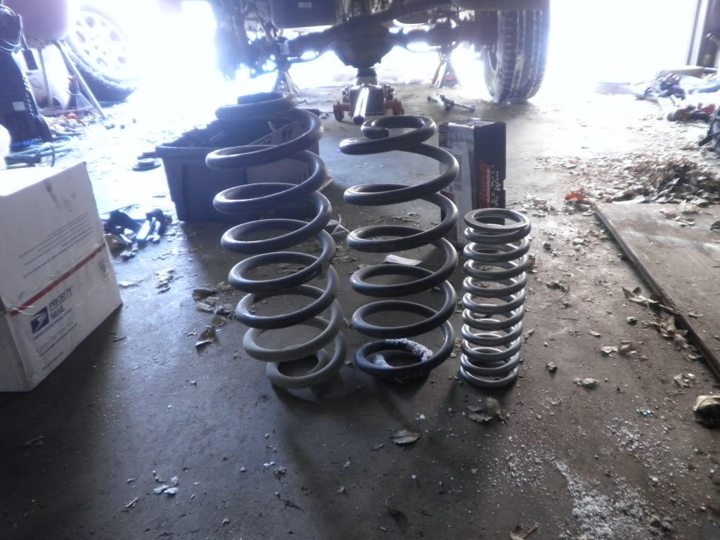

02 z71 vs. 00 suburban vs. QA1 10-350

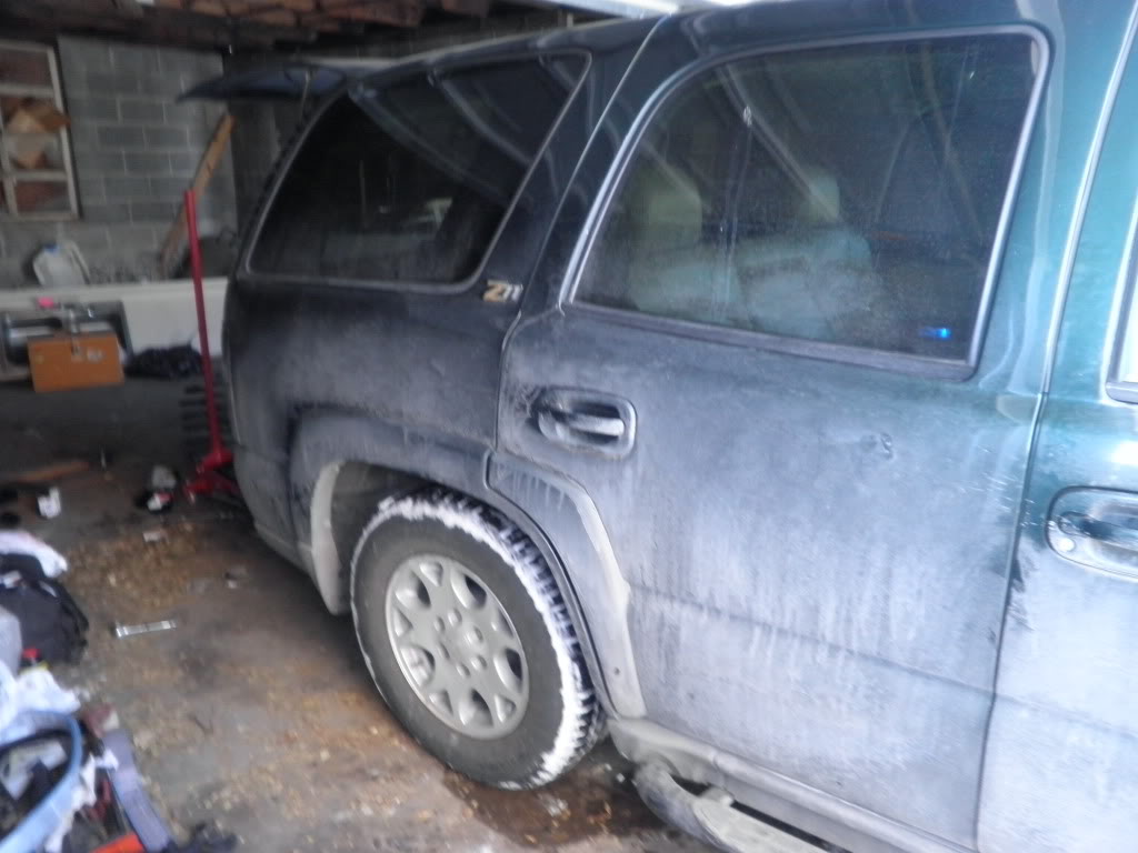

truck on qa1 10-350 32 1/2 inches from the ground cant remember my tire size.

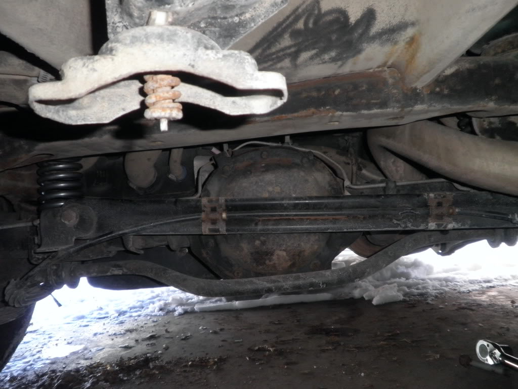

how the panhard bar sits

-its a 10 inch coil with the entire weight of truck it compressed to 8 inches

-as far as the panhard bar sits i know nothing.
