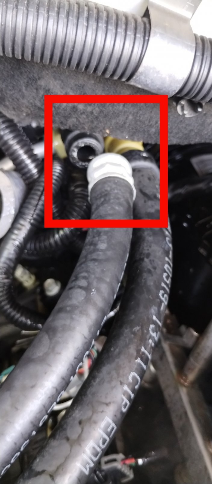

Okay, just went from bad to worse. I took her for a quick test drive and she started smoking just as I pulled back up my street. Popped the hood and found this.
Is this a line that leads to the heater core?
