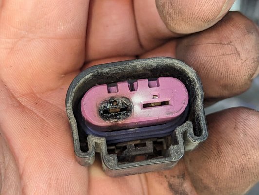

Checked my fan plugs, they both look clean.
So, if I understand the circuit, on high speed they each have their own separate 12 volt circuit (positive and ground), resulting in high speed for both fans. Both fans do run on high speed when it's called for.
If I understand the low speed circuit...the two fans are wired in series and basically sharing the 12 volts so that they each get effectively 6 volts, which makes them run slower. So, if one is running, doesn't that mean that the other must be getting power? So could it make sense that maybe the fan that doesn't run on low speed may be bad in some way? Or am I missing something about the logic of operation? Also, when I spin that fan with my hand, it is a bit squeaky. Maybe it's got bad brushes and only works when it's getting 12 volts.
I think my next step is to test for voltage on the second fan when the first is running on low speed.

As an update for future reference. My driver side cooling fan operated as normal. The passenger side cooling fan was only operating at high speed. Low speed would do nothing. I removed the motor and removed the back plate to get a look at the brushes and inside of the motor. The motor had a bunch of 'debris' inside, reddish brown powder stuff. I used contact cleaner to spray that crap out. I put a bit of grease on the shaft end bushing. I put everything back together and it seems to be working OK. Hope it works for a while. I suspect I will need to replace that motor in the future.
