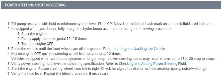

...reman vision ps pump. Put about 2000 miles on the truck and since I put it on the road I always had a ps groan or whine at the higher rpms 1000-1700rpm. Blamed it on a bad rebuilt pump. So I put a new gm pump on it. Same noise.
Air in the system, it needs to be properly bled.
New bad pump then is my armchair diagnosis.
