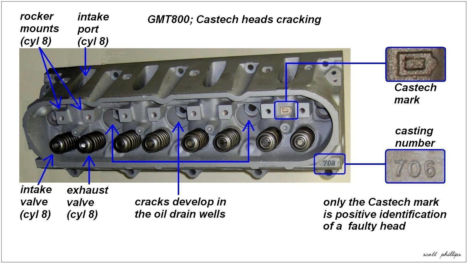

A mint, one-owner and documented well-maintained GMT800 is a dream find. The Castech issue really seems to be more with the '04-'05ish models. Doesn't mean you're in the clear, though. But, it's a much smaller problem than the AFM failure that has GenIV owners chewing their nails. You can monitor a cracked head and catch it before any real damage is done. It's not one of those failures that just happens unexpectedly and leaves you stranded. You can see the head casting number on the far right edge of the head. The heads are all the same (not right or left specific). On the driver side, you'd look near the firewall and, on the passenger side, near the front by the belt tensioner. I think there were the same issues with the 706 sister, the 862. The '03 would have either of these. The only way to tell if it's a Castech head is to remove the rockers and pedestals.
If you have a decent mechanical aptitude, you can repair a Castech failure if it happens. We've walked members through diagnostics and head replacements and even full AFM deletes on the GenIV engines. If it's not consuming coolant, I wouldn't be so concerned about it.
Casting number location. This is on the passenger side of the engine:

My 2004 made it to 165k before my Castech heads cracked. Replaced them myself 2x because the refurbs cracked, too.
Identifying the casting number 706 is a good start (there are reports of 862 cracking as well, but rare) but to know if you have Castech made 706's you need to pull the valve cover and remove the rockers and stand, to look for the manufacturer mark.
