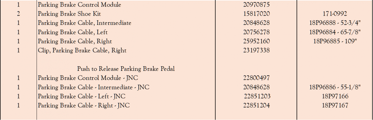

Our parking brake cables rusted and broke at the front cable to middle cable splice coupling.
Looking for cable oem part numbers there are two design versions. Anyone know the difference?
The difference is whether you have the push to release (JNC) or the handle to release the parking brakes. The lengths of all the cables are different, actuators are different of course and then there are ACDelco and GM OE.
I have the part numbers for both styles for a Suburban or Yukon XL.
