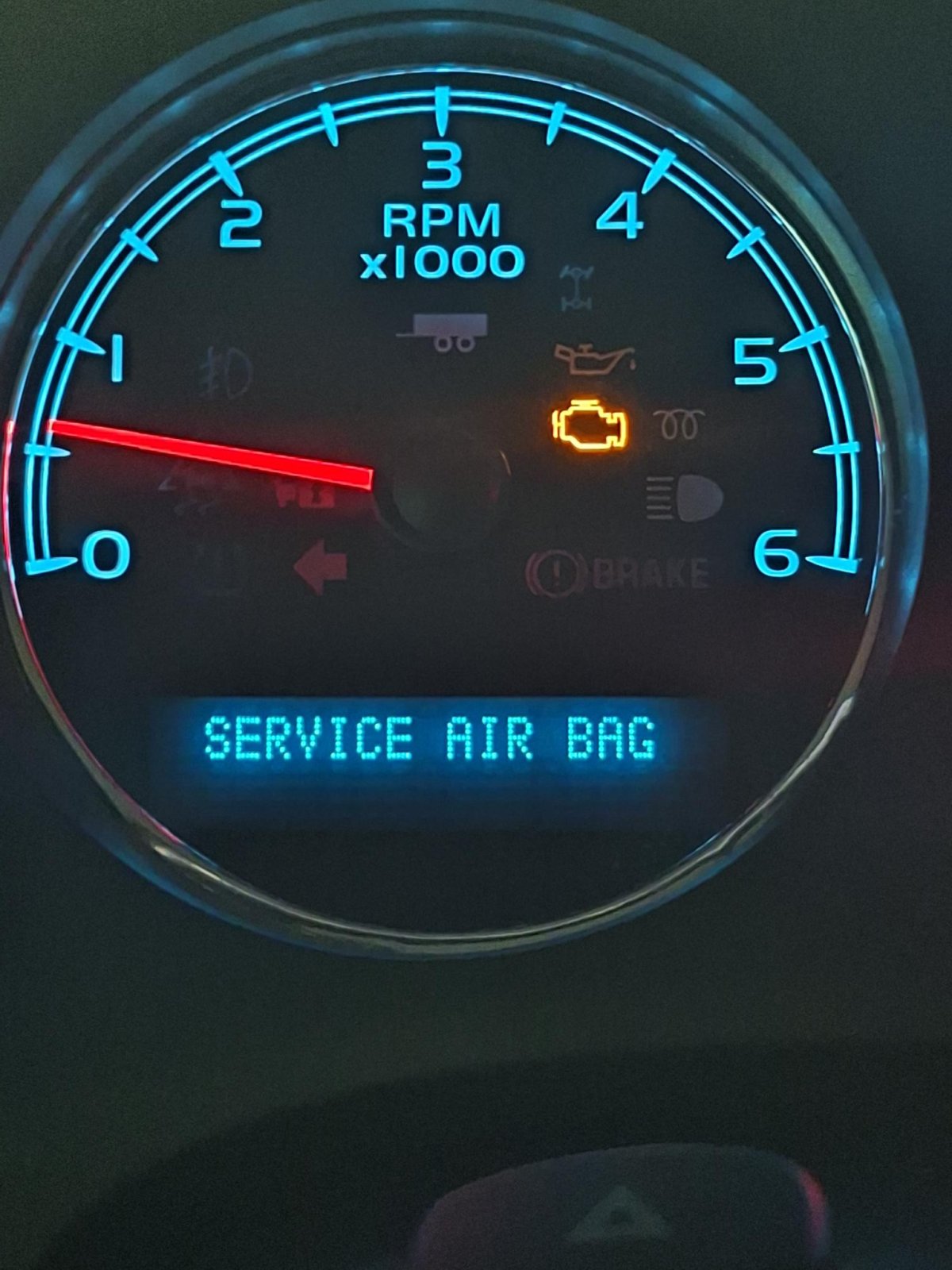

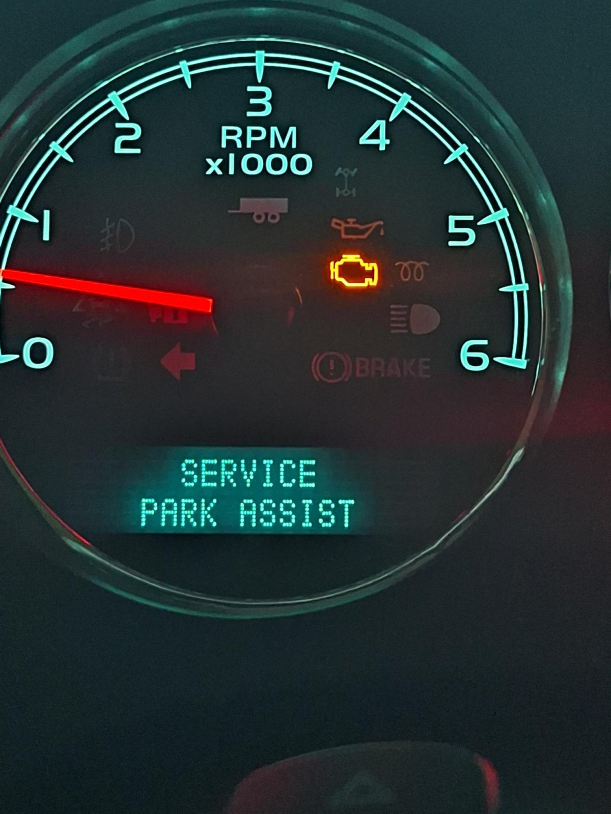

Any updates? Mine just tripped this weekend and says "service park assist" and now my airbag light is on. I do have a trailer hitch on mine

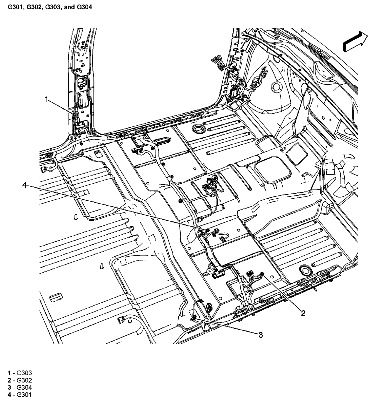

Best to find a way to read codes...
But they happen to share a ground point.. ground zone 27 in this diagram..
G302 or #2 in this diagram.. Looks to be under passenger seat.
