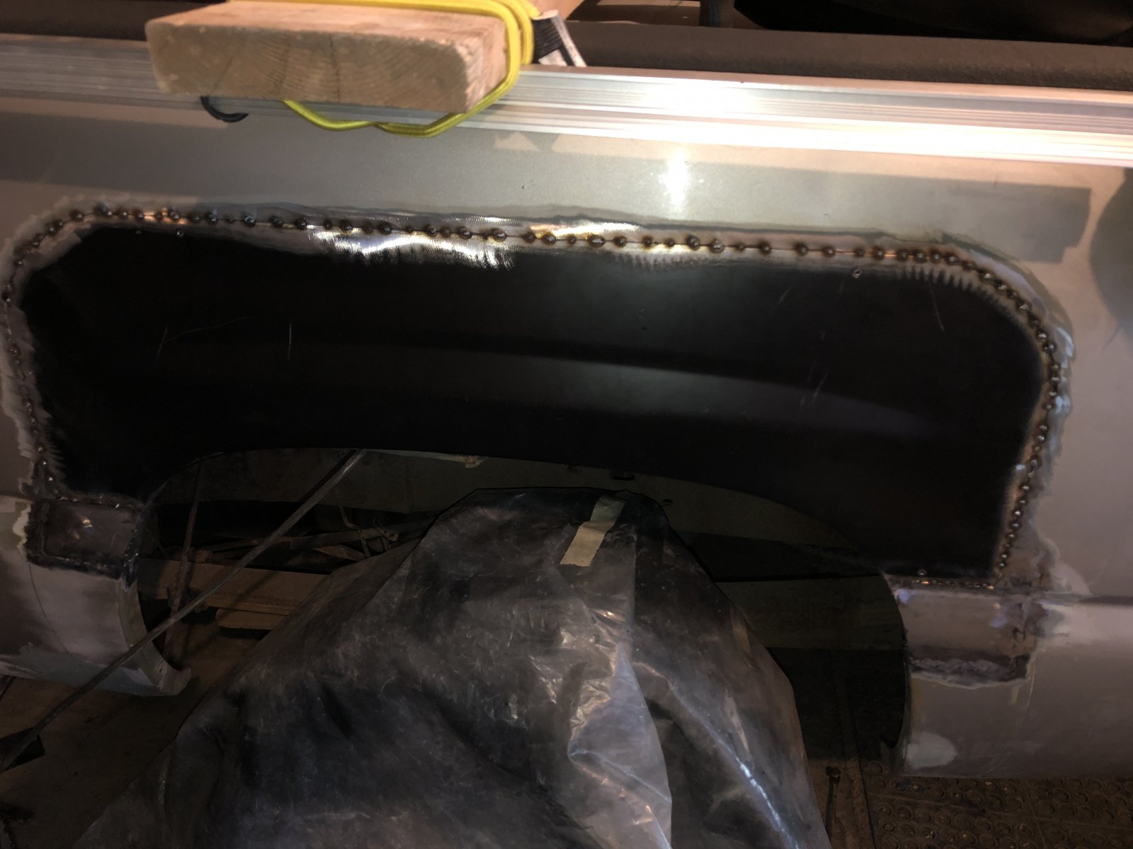

Being in Canada rust is always an issue and like most of these trucks the rear wheel wells rust out. Trying my hand again at rust repair.

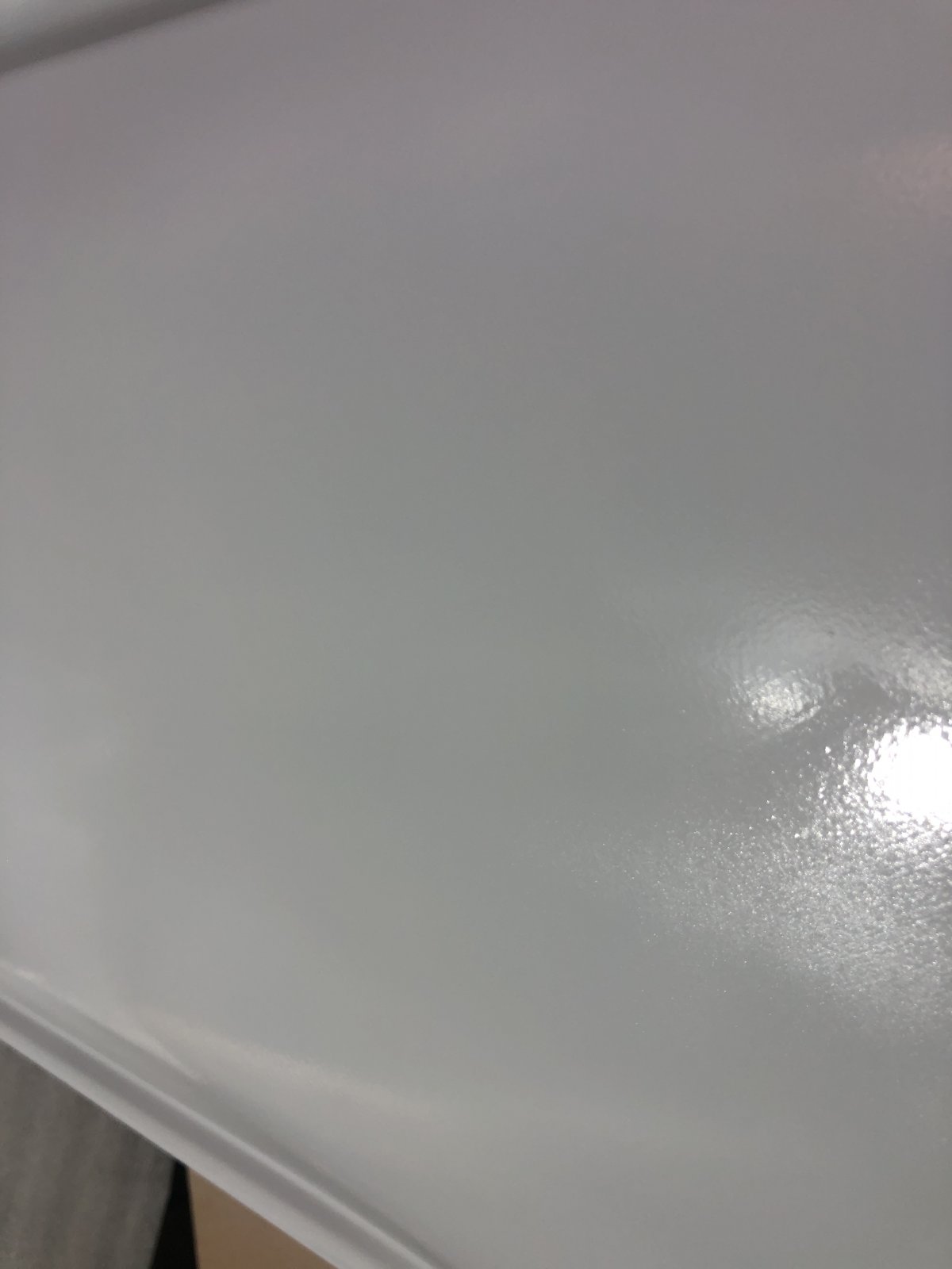

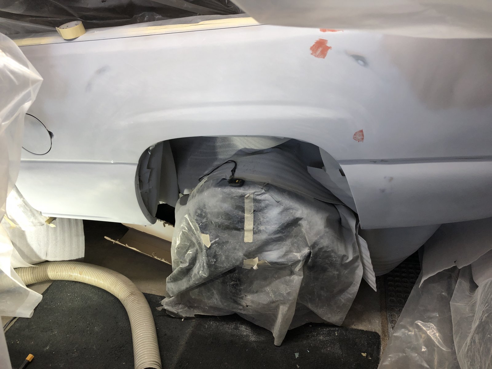

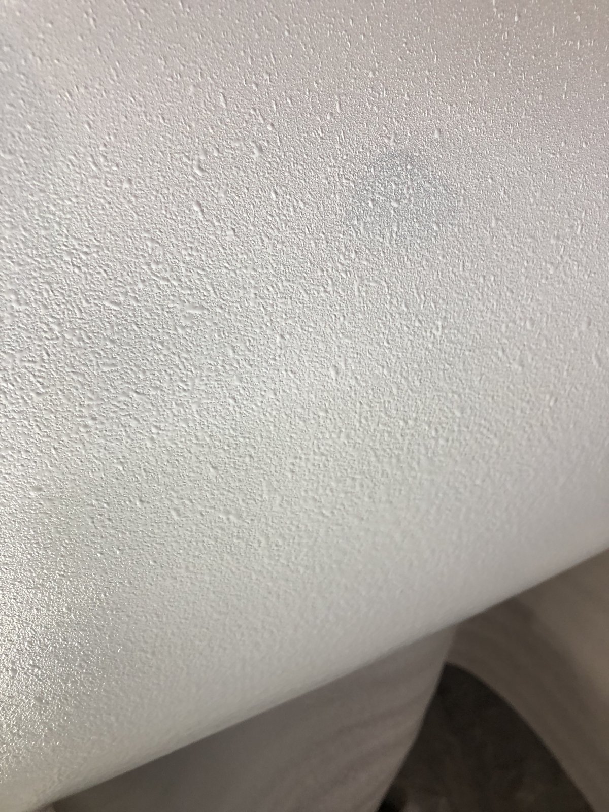

Purchased replacement panels so metal work was much easier this time around. D2ECDE35-F450-432A-9321-FBDFD86B7244.jpegAfter some bondo and sanding.ABF03788-866E-409A-A2A7-CD501438EF9F.jpegI have a HVLP gun that I’ve used for cabinets,interior wood work ext. thought I’d use that this time around since the area is much bigger. Not having any experience with this has slowed me down a little. Spraying high build primer was a flop on first attempt. Came out like ceiling texture.58335119-F613-4D21-B098-CCB542276B0A.jpeggot that sanded off. Arg. Finally got it to spray by thinning it down a little. Even with a 2 mm tip still needed thinning. Anyway that’s where I’m at. Going to spray 2 coats on today and start block sanding.64581D04-36E7-4456-B857-8FD8853F02F7.jpegfairly easy to spray this high build. Don’t get much overspray. Last night’s test was easy to sand this morning. I think it’s all pretty flat but will find out once I start using a guide coat and block sanding.AC1C94BB-8BCE-4105-BC51-385EC2FCE71F.jpeg

Got two coats of primer on in my little booth. I think I spend more time cleaning the gun than anything. Rattle can primer is so easy and takes no time. I guess you don’t get the thickness so there’s something to sand down now. Starting with 220 and I’ll work my way up to 600 wet. Metallic colour so from what I’ve learned 6-800 wet before base coat. 6D87072D-025C-492E-95E2-9F17855B8F5D.jpeg24D8845C-6529-4C91-9E43-B2D5D016531E.jpeg
