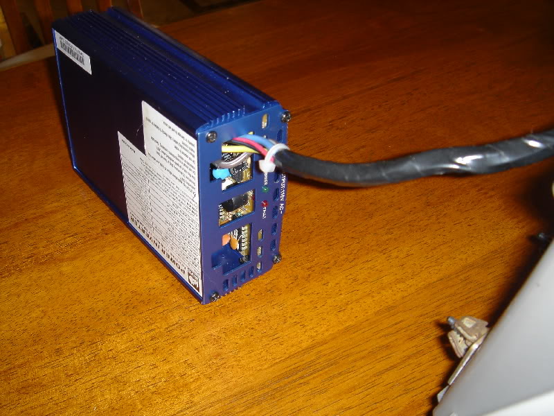

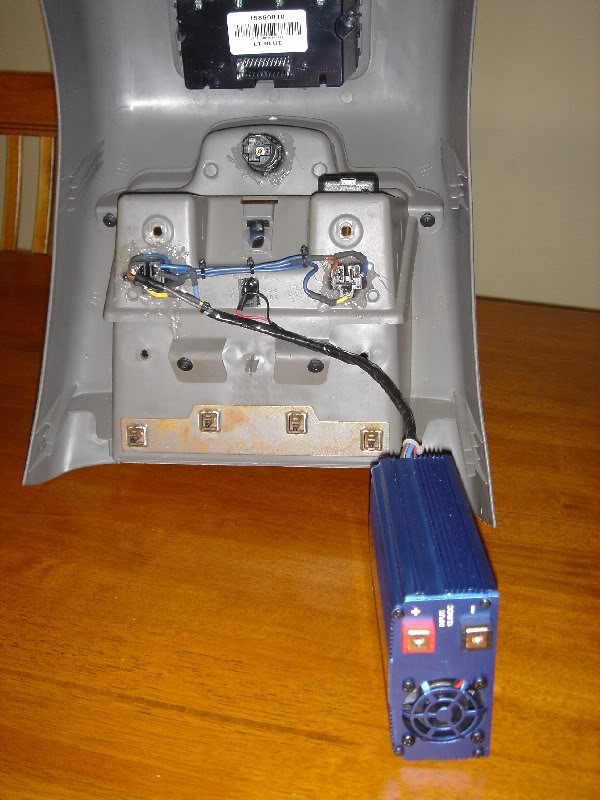

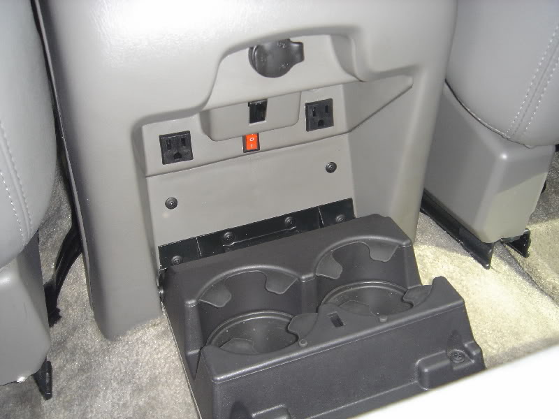

I did something similiar here:
http://z71tahoe-suburban.com/iboard/index.php?showtopic=20255&hl=
the only questions i have are how did you extend the plugs
What I would do, if I were you:
1. Buy an inverter with enough power for your needs.
2. Buy a REALLY, REALLY cheap one that you are just going to take apart for the black plug face. Install black plug where you want it on the dash. You may have to do some epoxy on the back, so it doesn't pull out everytime you are removing your laptop's power cord.
3. Go to Home Depot (or your favorite Home Depot type store) and purchase a power cord like this one:
Power Cord
Plug in one side into your converter, and solder the other end onto the the plastic plug outlet you have mounted on your dash.

That was very nicely done, Omar. I never thought about that location and yours looks so sweet I am gonna copy it! :head3:
I might have to make it GFCI protected in case a Big Gulp® riding there gets jounced while the power is on. :D

Yeah, pretty sweet custom install for power, and it's very practical and I may also have to copy it!!
