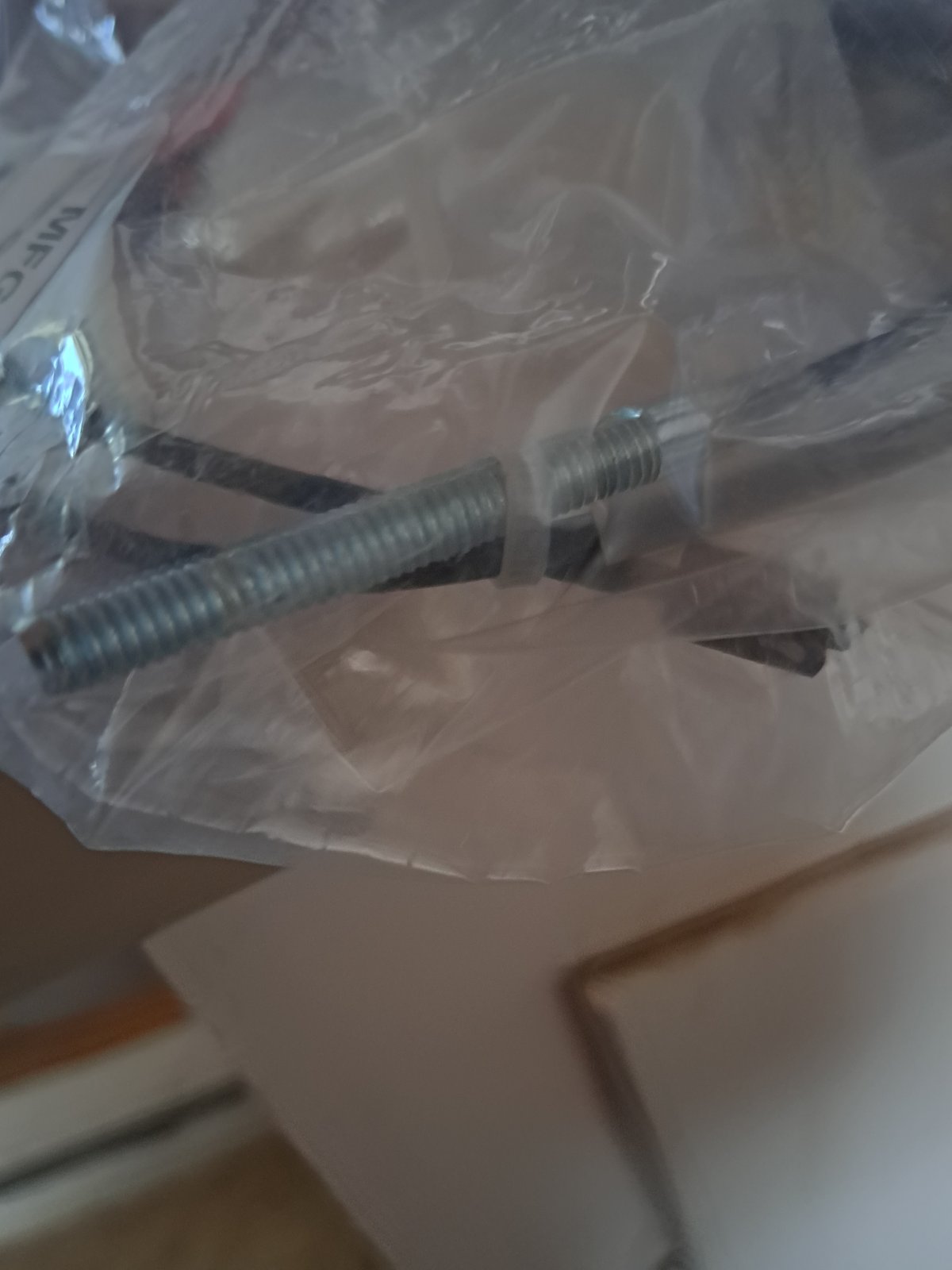

Ok, that's the one I got, too, from RA. No nut, and no new dual cable connector, though. The bag had been opened, so I'm not sure if either should have been there. My old ones are in good enough shape.
Mine is just the cable

Ok, I had the annoying rub noise from the rear park brake cables not allowing retraction and shoes rubbing inside drums for the parking brake. I bought all the cables from the park brake actuator under the dash to the rear. Turns out the front cable and the intermediate cable were in excellent shape and in no need of replacement. The only problem cables were the rear cables. We took them off and actually had problems pushing and pulling the cables thru the housings. That was the problem even in the no salt the roads PNW. We replaced the cables at the rear and adjusted as needed and the park brake works as should and holds the truck on a steep hill, even in neutral. Could not be happier. After my recent 5500k mile trip and that noise/problem coming up, I am now satisfied with the repair. No more rub noise at all. I actually hated not being able to set the parking brake. It is a parking brake and not an emergency brake. God Dammit!!!!!!!!!!!!!!!!

I'd be curious to see what the threaded end and nut position look like after your full cable replacement. And I assume that you had to remove the pedal assembly to replace the front cable -- or didn't you change the front ones?
I replaced both rear cables on mine but it made no difference to the cable length, and the threaded rod is adjusted all the way. I suspect that one of my other two cables (front and intermediate) is slightly stretched. But the parking brake shoes are adjusted better so it does hold for the most part.

I already sent the unused cables back but the rear ones fixed the problem of noise. If I did the front cable it would have required the removal of the park brake assembly under the dash,
