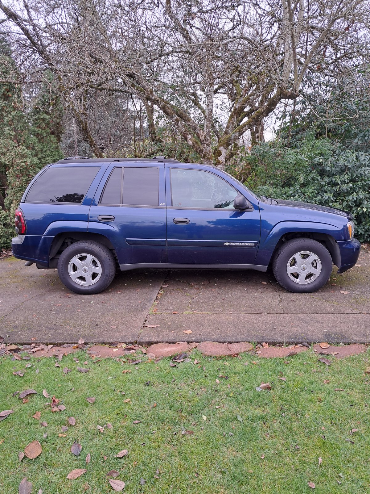

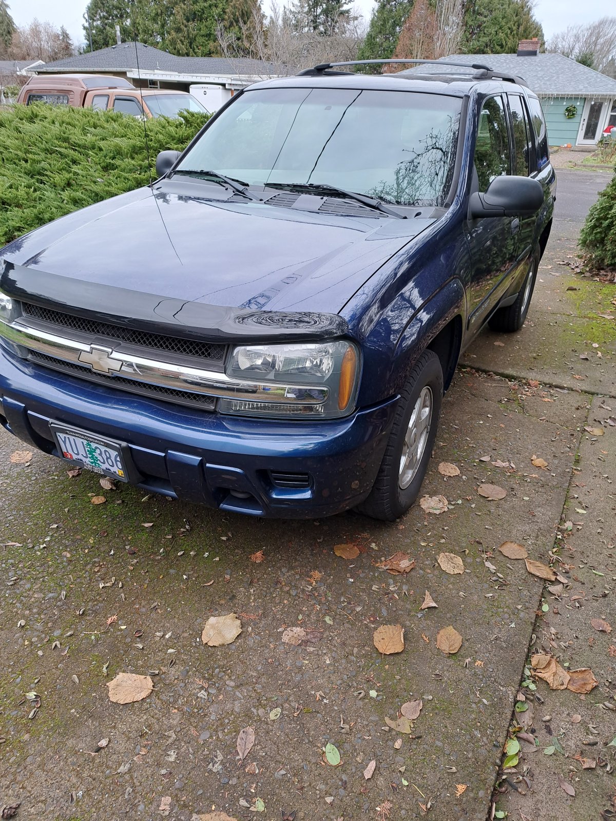

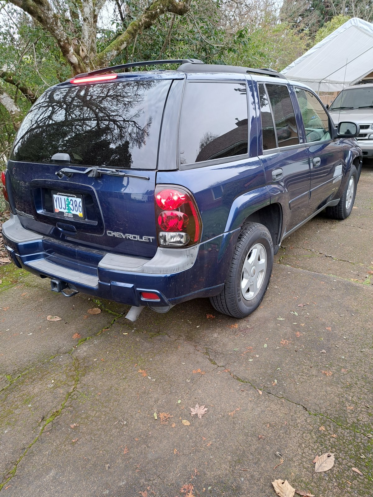

Really clean and looks to have nice tires. Good luck!
Oh, Cerakote would fix that faded trim and last for a while (like, a year or more).

Soooo, ended up buying the TrailBlazer for $7400. She just could not pass up the no dents, no tears, AWD, 70,212 miles and wanted one more test drive. We drove to my home and ran it up on the ramps. I had my blinding light out and looked all over for any leaks. Everywhere, and I mean everywhere was dry except for one place. There is a splash shield under the front area that has a small square window that is removed for oil filter access and it had orange drops hanging from it. Coolant. I looked up and saw the orange drop hanging from back of the water pump pulley. The price was $7500 till the drop and was now down to $7400. She wanted it and we bought it and I already ordered the new water pump and new thermostat with water outlet housing and new wiper blades because they streaked. The electric fan clutch had been replaced 35k ago. Here are the pics. Look close for the orange dot of coolant.
