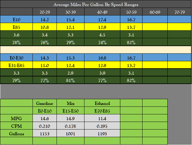

You fellas might consider running a mix for better fuel economy. Mine gets better mpgs with an alcohol content of between 16-20% or so compared with 93 octane gas. I do not ever intentionally burn straight 87 gasoline.
You can see the percentage difference also between burning the differing fuels. It's not as bad as some think.

Here's where we're at with the Sierra so far:
In this truck, the difference between burning 93 and any mix of Ethanol is even less so far.
