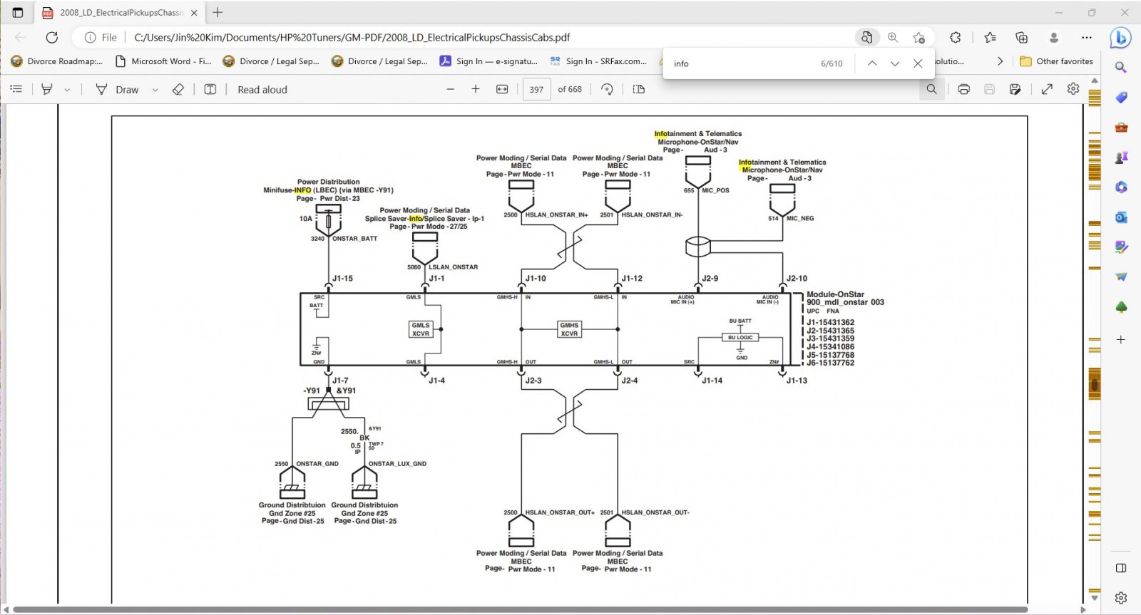

Pretty sure you can remove it **IF** you jumper 4 GMLAN wires.. (not all together, 2 and 2)
See attached file, I am guessing J1-10 and J2-3, J1-12 and J2-4..
I opted to leave it plugged in so I wouldn't have to make jumpers and worry about them coming loose.
Instead I disconnected the antenna, radio board, and power (INFO fuse).
If you wanted to retain bluetooth phone interface, you can just disconnect the radio board inside.
(when you disassemble the VCIM, there is a jumper connecter that unplugs, search youtube!)
