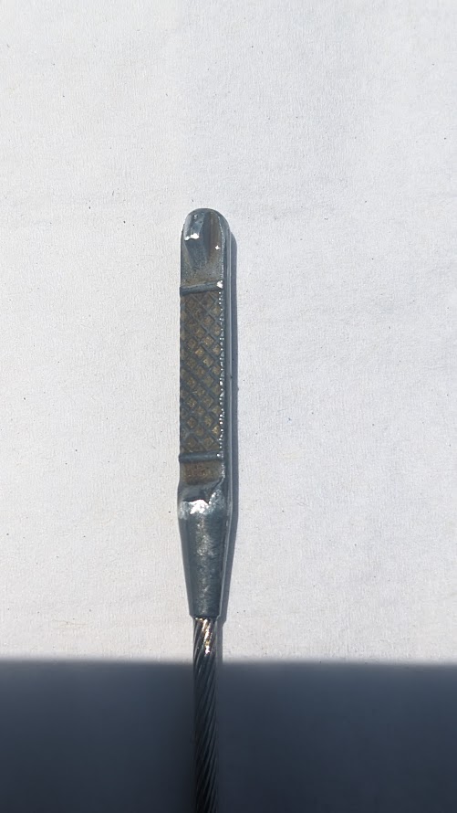

@Kpwweb and anyone else reading this thread.
Below is a picture of my dipstick with the oil level at 9 quarts. Notice the oil level is just above the top line above the hash marks, maybe 1/8" tops. Matches the same level I found my oil level in the engine when I received the vehicle with 8 miles on it and the same as 2 - 2025 6.2l Yukon that had 7 and 40 miles on them. Other members have seen the same situation.
I had to wait until the oil had some color so you can see the oil easier. Have about 2000 miles since the last oil change and the color is still very light.
Notice how heavy the oil is in the hash marks, it needs to be this way, as I mentioned in the picture that Kpwweb posted above, his oil level is about 2/3 low on the has marks. It is not that oil has flowed to the bottom of the dipstick. The oil must have a thickness as seen in the picture below, This is why there is plenty of confusion of the oil level in these engines.
Take your dipstick and dip it in some used oil 1/2 way up the hash marks and look at it, then do the same at the top of above the hash marks and see what it looks like.
You guys do what you think you want to do, I am running 9 quarts with filter change as are my 2 neighbors with their 2025 as they saw the same oil level in their engines at time of delivery. I am sure I will have PLENTY of "you overfilled your crankcase, the crank will aerate the oil and you will have a crankcase full of foam". Well not the case, I have run 9 quarts of oil for the past 7500 miles and never have I had any problems with foam, oil leaks, oil consumption or any other negative effects. If 1/8" above the top full mark has the crankshaft frothing the engine oil below the windage tray we have bigger problems. I could probably put 1-2 more quarts in the engine before the level would be anywhere near the crankshaft.
For everyone else, enjoy running your engine chronically low on oil.
I checked my oil yesterday and it is at the upper mark. The “hash marks” are totally saturated. That is with 8 quarts. No more, no less. It is NOT 2/3 the way down.
