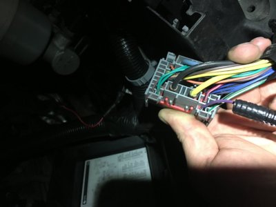

IMG_3319.JPG IMG_3318.JPG Yeah, I think I got all those steps, but doesn't work. It's a ssv if that makes a difference.
The light on the dash isn't coming on either so I assume the computer isn't recognizing it.
Here is a pic of the switch plug, I noticed not all the pins have wires to the harness.IMG_3317.JPG
