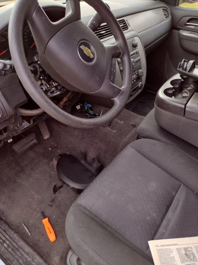

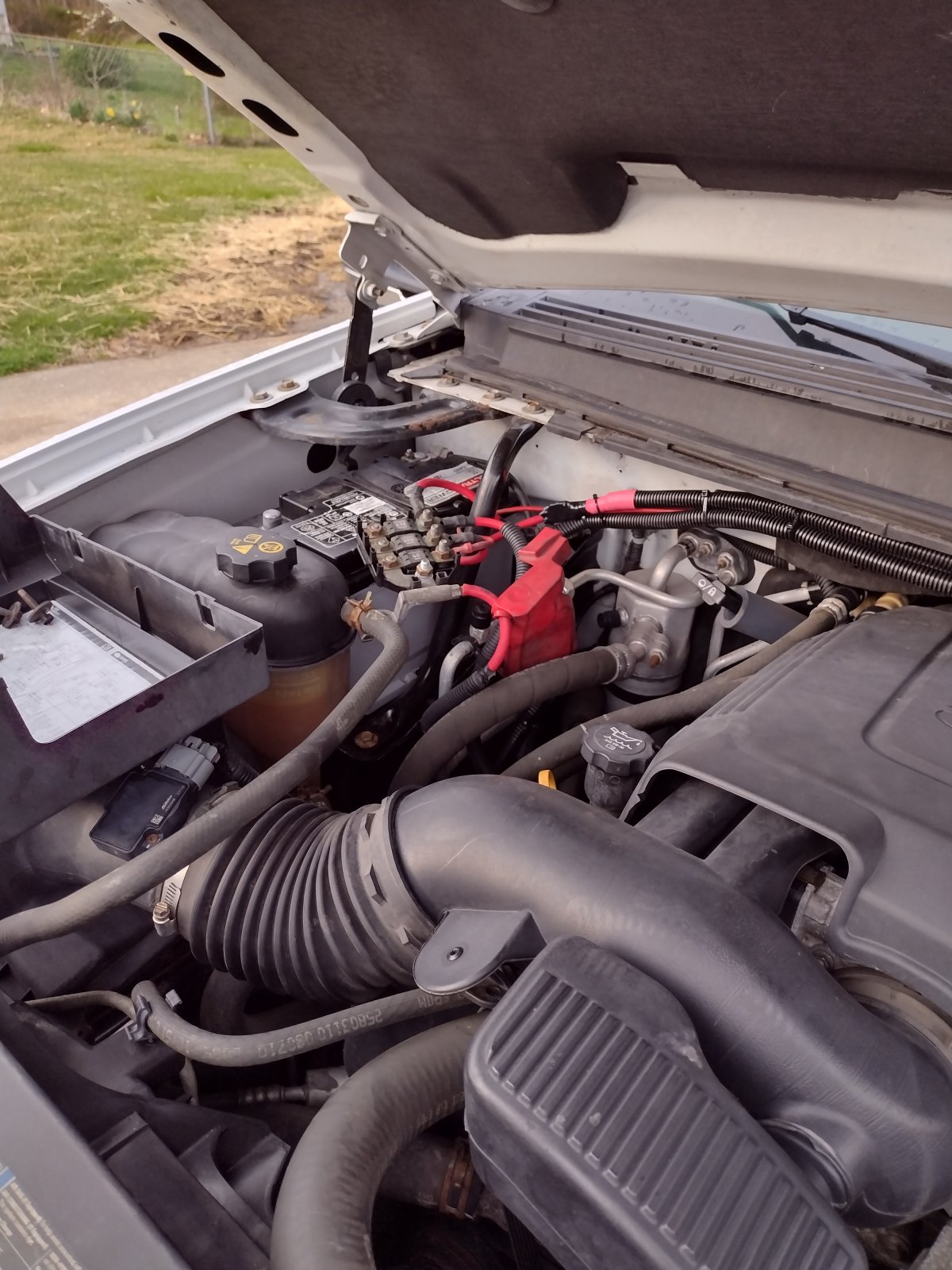

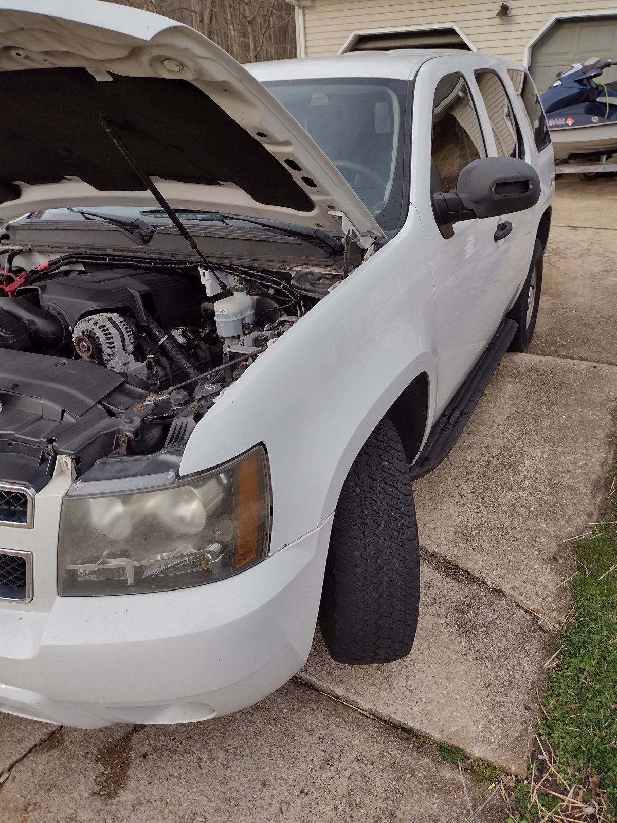

So I pulled the cover off of the steer column did not see any add-ons cut wires or etc.
So I am assuming it is in between the fuse box under the hood and and where are the two pigtails tee. But anyway here are some pics
