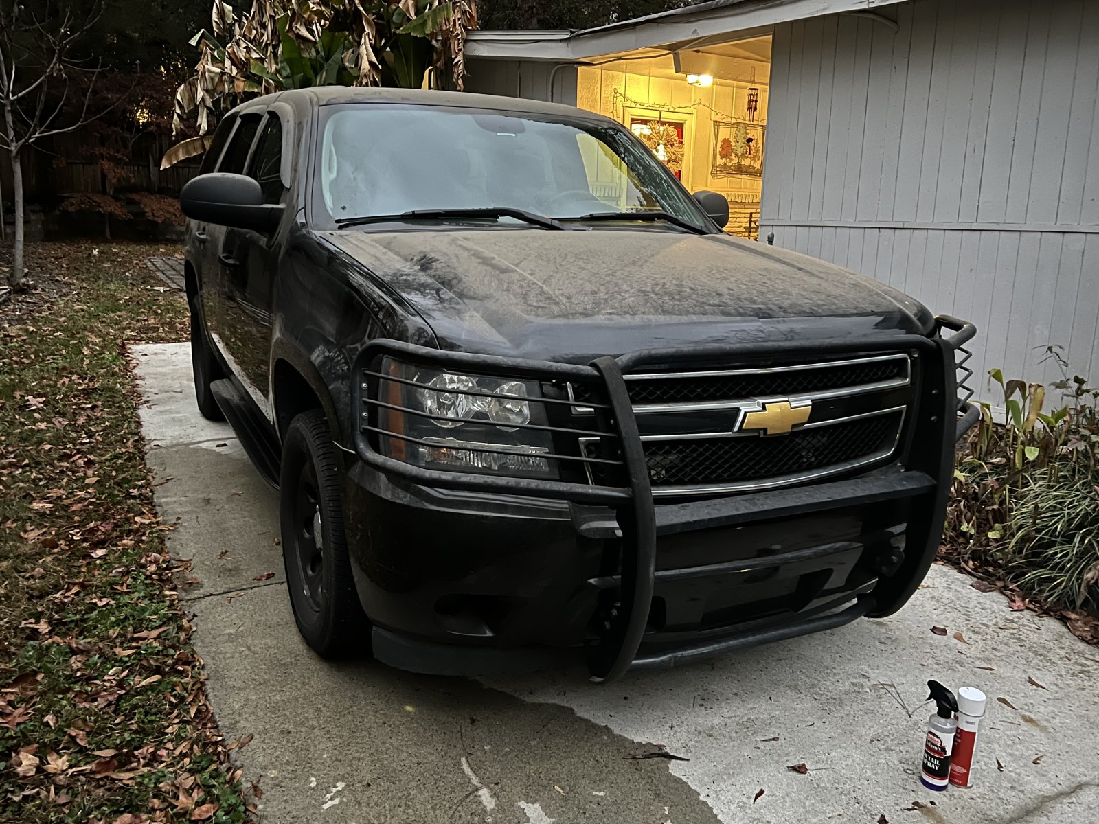

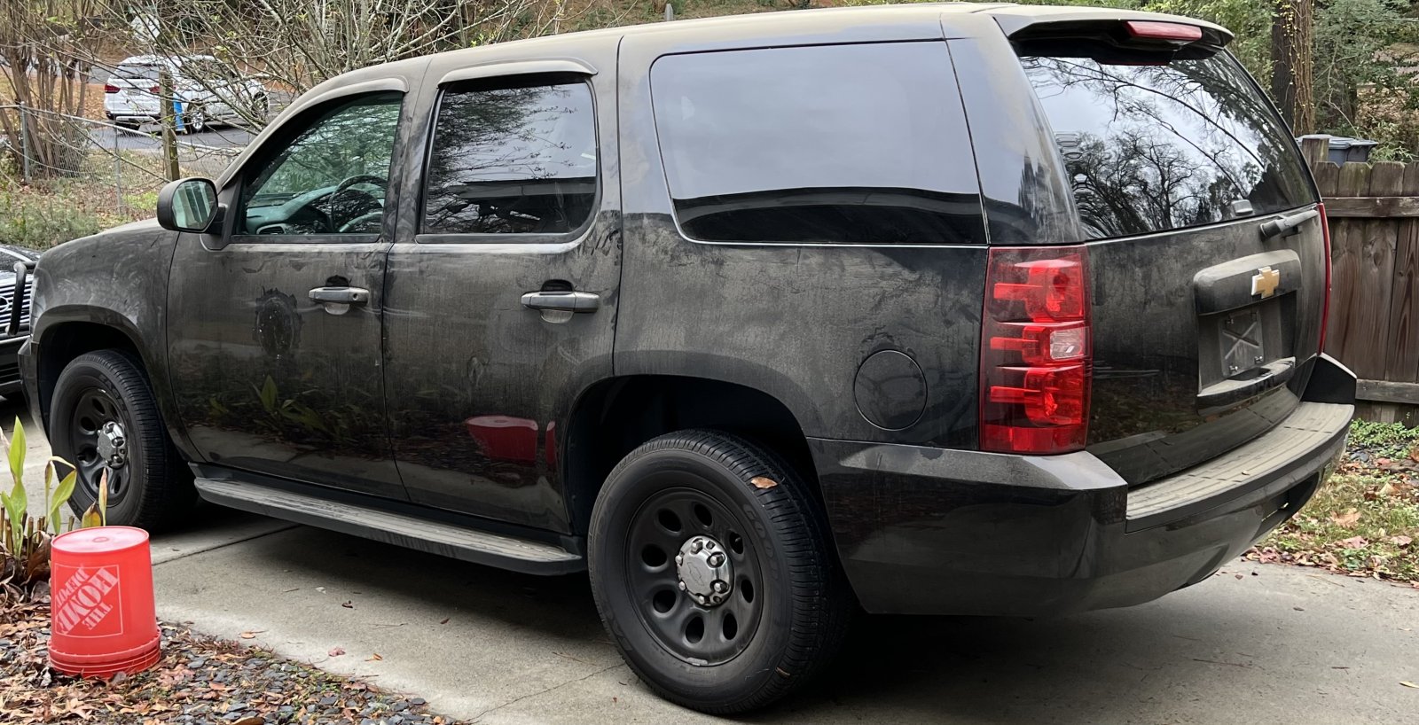

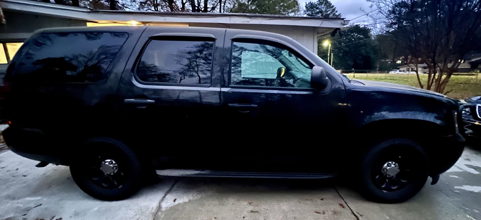

Here it is in all its dirty dusty glory!
