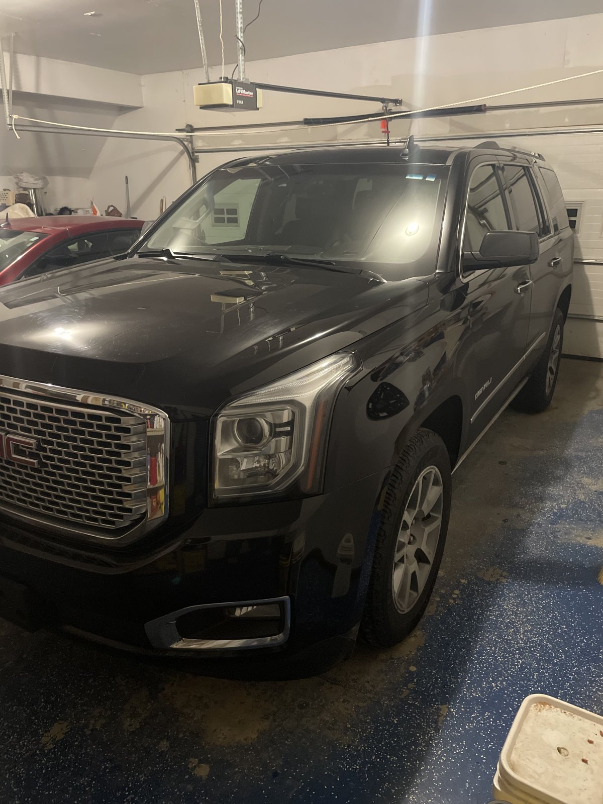

New to the site - pics of my 15 yukon

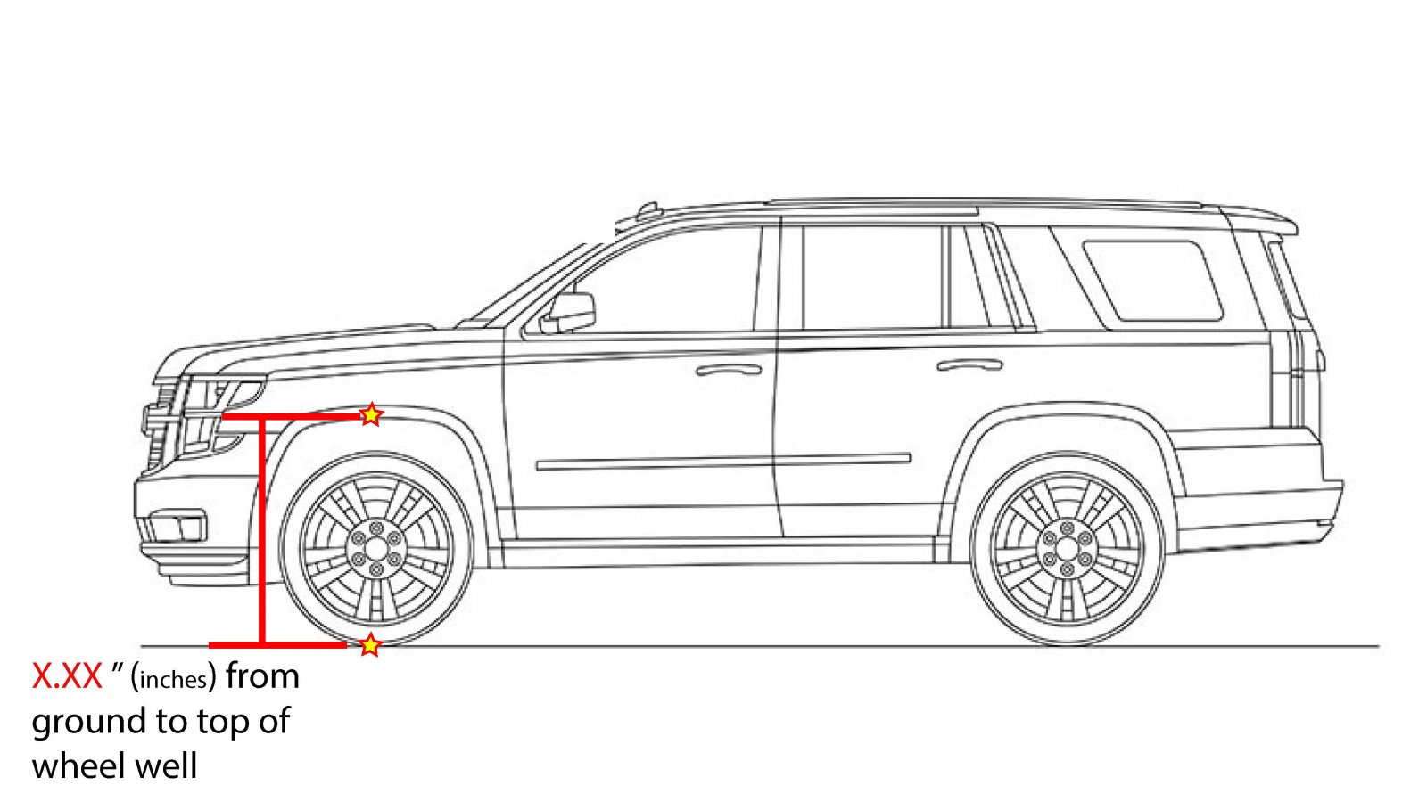

Want to do me a HUGE favor? Measure from the ground to the top (highest point in the arch) of your wheel well on the front and rear. I'm running these 4-6" adj. Fox coilovers up front and ride height is so far from stock and so much time has passed; I would really appreciate a good measurement. Your setup is a perfect one for me to use as comparison. I have a feeling my front is really closer to +5" instead of 4"

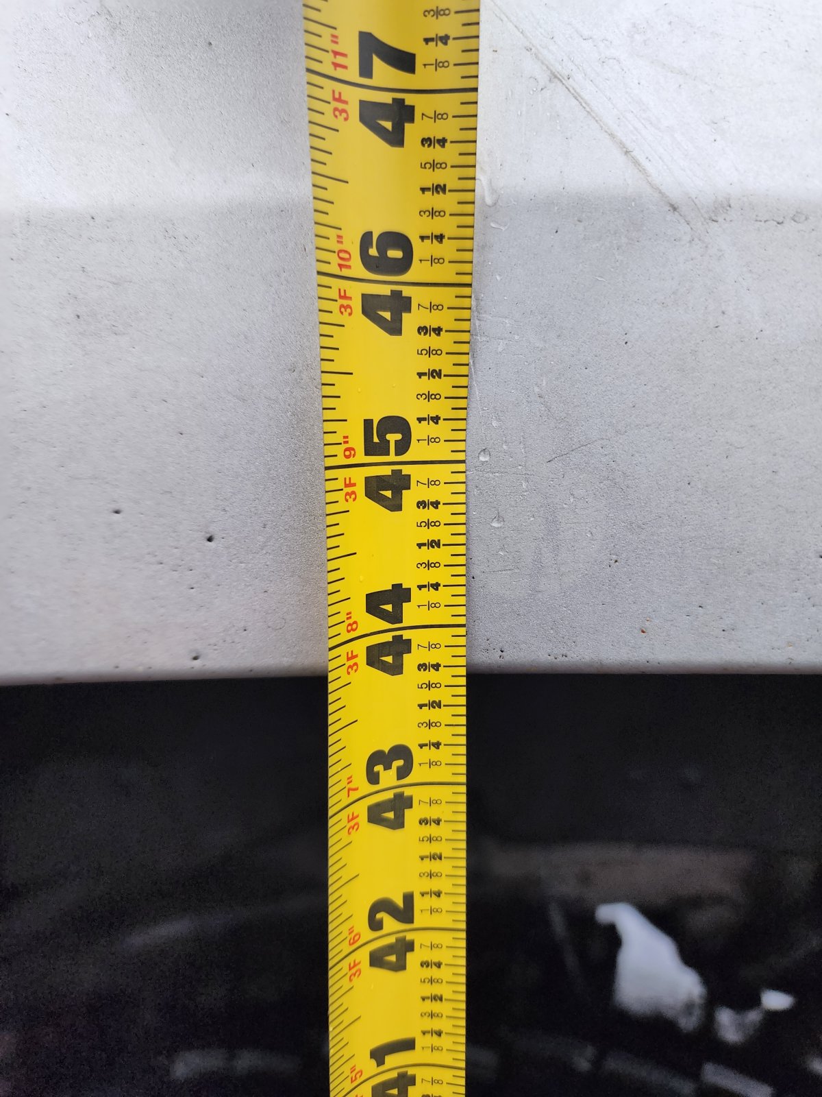

I'm still running stock socks. That's the next thing I was looking at doing. So you're feedback would be appreciated.
I've had it for like 5 years and got the lift done like 3 years ago I think.

@iksplizit - THANK YOU! Appreciate you taking the time for measurements and photos.
Did some math on the front end, using your Front Left measurement vs. my current measurement.
Your 35x12.5 ProComp A/T Sports are spec'd at 34.6" vs. my Nitto Ridge Grapplers spec'd at 34.29.
So, in terms of ride height difference, that's only about 1/8" more for you with the wheel/tire combo.
The difference in your total ride height measurement vs. my height, less the wheel/tire height increase, leaves 2.375". So your 6" Fabtech vs. my 4" BDS is netting 3/8" more height than the advertised 2" diff.
This has been a concern of mine for quite a while now. Have been wondering just where my Fox 2.0 4-6" adjustable coilovers are actually set for ride height. Now I see that they are pretty much in line with the 4" setting vs. having some preload cranked into them (exactly what I was worried about). This is also probably why I'm enjoying these front coilovers so much. They have a really nice amount of travel and eat up bumps amazingly. I think if they were moved up to the 5.5/6" ride height preload, the overall driving experience would be a lot stiffer. This is also why I keep finding myself unimpressed with the rear-end performance (3" coil spacer with standard nitrogen charged shock).
