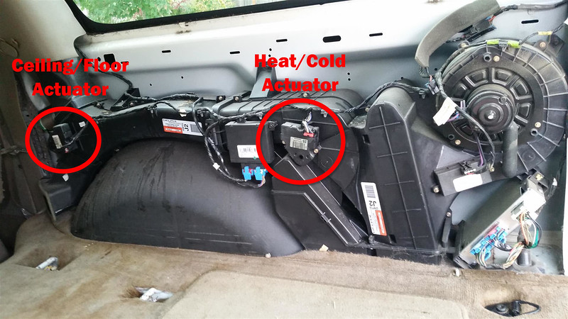

REAR HEAT
I was able to troubleshoot the rear heat issue. I swapped the Floor/Ceiling actuator with the heat/cold actuator. I was able to get warm air, so ordered a new actuator from Amazon.
https://www.amazon.com/gp/product/B004AIHNM6/ref=oh_aui_detailpage_o02_s00?ie=UTF8&psc=1
The dealer wanted $150 and the local Oreilly auto parts wanted $120, so I decided to go with Amazone. The actuator works just fine...
In case you are wondering where the actuators are located
[/url][/IMG]

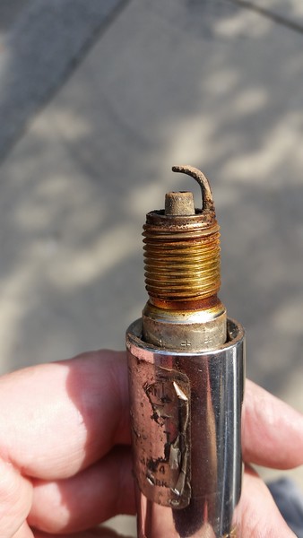

My intent wasn't to create a rocket, but I wanted good quality parts. It was good that I replaced the plugs :) There was only a single plug that actually had an electrode still intact and it was gapped at 0.030 :(
The misfire is gone and I'm seeing about 1-2 mpg improvement. I gapped the plugs at 0.045...there are some folks who say an 8.1L should be 0.060, I'll run the lower gap for now and pull a couple plugs after 1-2k miles and see where we are at...

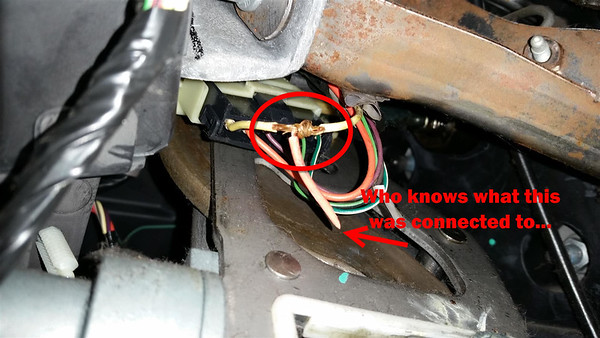

I also ran through the AirBag system and it's turning into a larger job than I originally thought. The seat appears to be a junkyard seat...there are a couple connectors that aren't connected...one of which is supposed to connect to the Seat Position Sensor, which doesn't exist! So, I'll be digging through some local junkyards for a complete seat mount.
I also started looking under the dash and it appears the previous owner (hereafter known as Mr Hackjob) tapped into one of the airbag wires for powering something? It's been cut and spliced back poorly, so I fixed that and taped it back up. Hopefully the only part to repair is the seat position sensor :mad:
