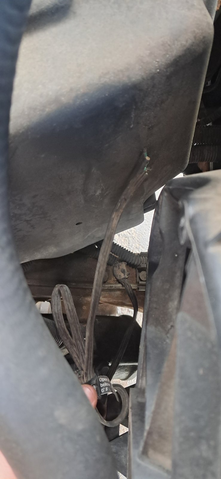

This wire looks cut by the driver's side frame rail. I'm not sure if it was from service or emergency lights in it or old factory fog lights. Chasing the wire, it looks to travel up to the firewall. There are some patched wires under the center cup holders but I didn't test them for continuity just yet.
There are no fog lights installed, so there's nothing to reconnect.

That wire in the 1st pic almost looks like it could've been a block heater. What does the attached tag say?
It had a little electrical diagram on it for the 3 wires. No real identifier or P/N.
That's exactly what I was going to say, 110v AC. Tag says "operates below 0°F" or similar I'd bet.
