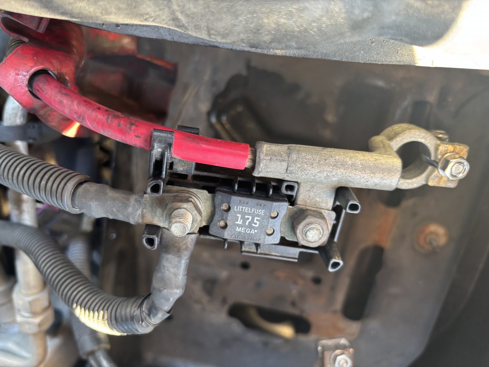

I guess first place to start would be replacing the positive cable??
I guess my question would be, do you have a volt meter or some way to check for voltage?
that fuse you see in your Pic is the 175amp meg fuse. if you can install the battery the correct way, and check for voltage after it, to see if it's blown.
then you'll basically have to continue to check for voltage along the way thru the system till you either find some place that doesn't have it but should. or find you have power to the correct pins of a module but that module is dead. this is going to be a bit of a learning curve if you don't have much electrical experience trouble shooting
That's the fuse.. If you can make a wire spark across the battery terminals, you could try and spark a wire from the left terminal pictured to the battery negative..
Should spark the same.. If no spark, it's that fuse.
THEN AGAIN.. trying to spark it... may pop that fuse.. (might not?)

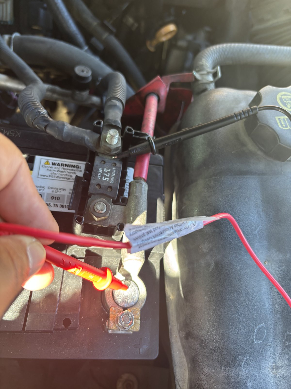

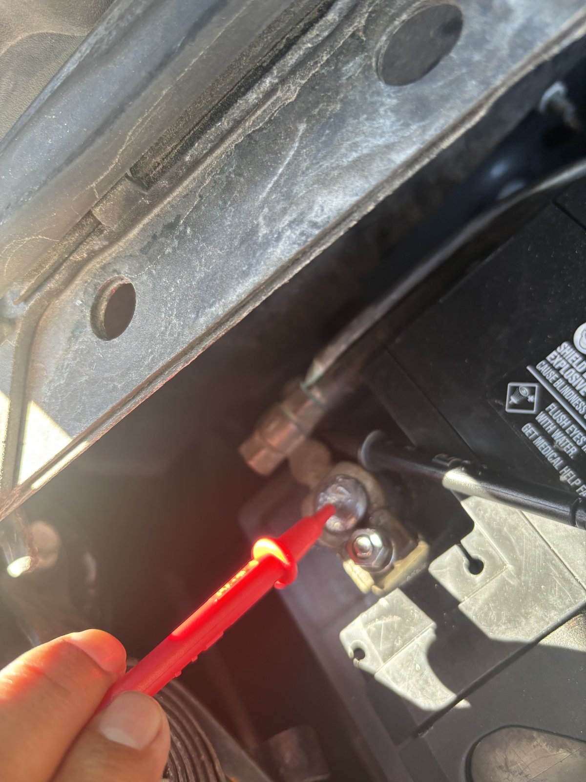

Checked after the fuse and it’s getting voltage 12.7… checked the negative terminal.. didn’t get a reading… also not sure if I tested at the right places ..but shouldn’t there be voltage on it as well??
I'm not sure you did that right looking at the pics.. . hang on.
so black probe on the neg post of the battery. putt he red probe on the pos, you should see 12v. on the meter. and then leave the black on the neg post, move the red to after the fuse. you should still see 12v. if not, fuse it blown.
if I'm seeing it right in the pic you're doing a voltage drop test, which is good to do and know but much but harder to explain the results right now.
Makes sense now… thanks!!!! … yes there’s no current after the fuse… I checked just about all the fuses and relays and all are good .. going to run down to get a new + terminal and hopefully swap it out today or tomorrow morning.

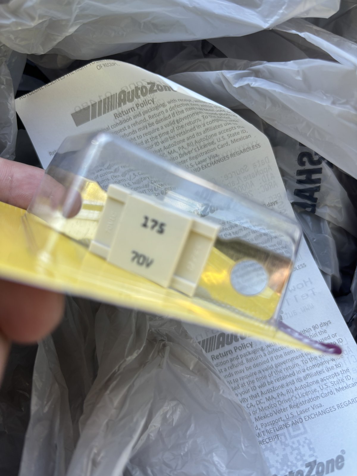

This is the one they had .. I’m assuming this will do?? 175 amp 70v
