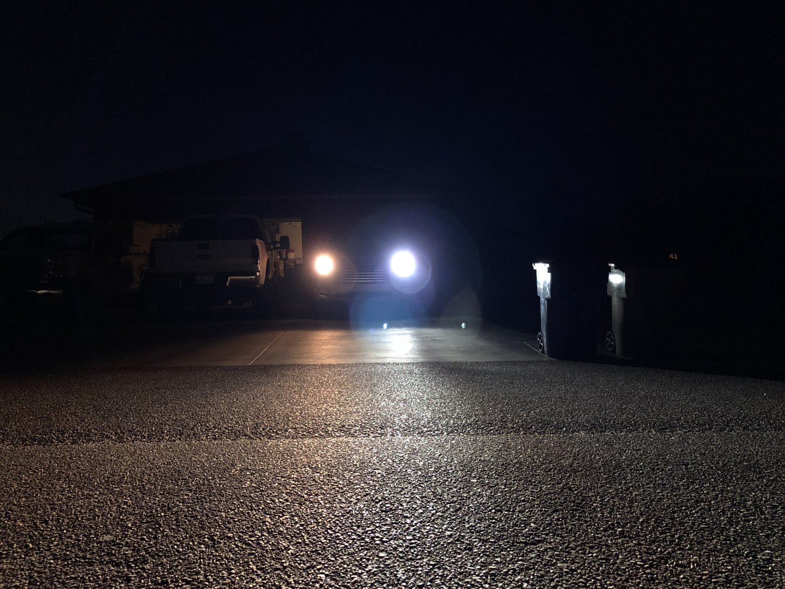

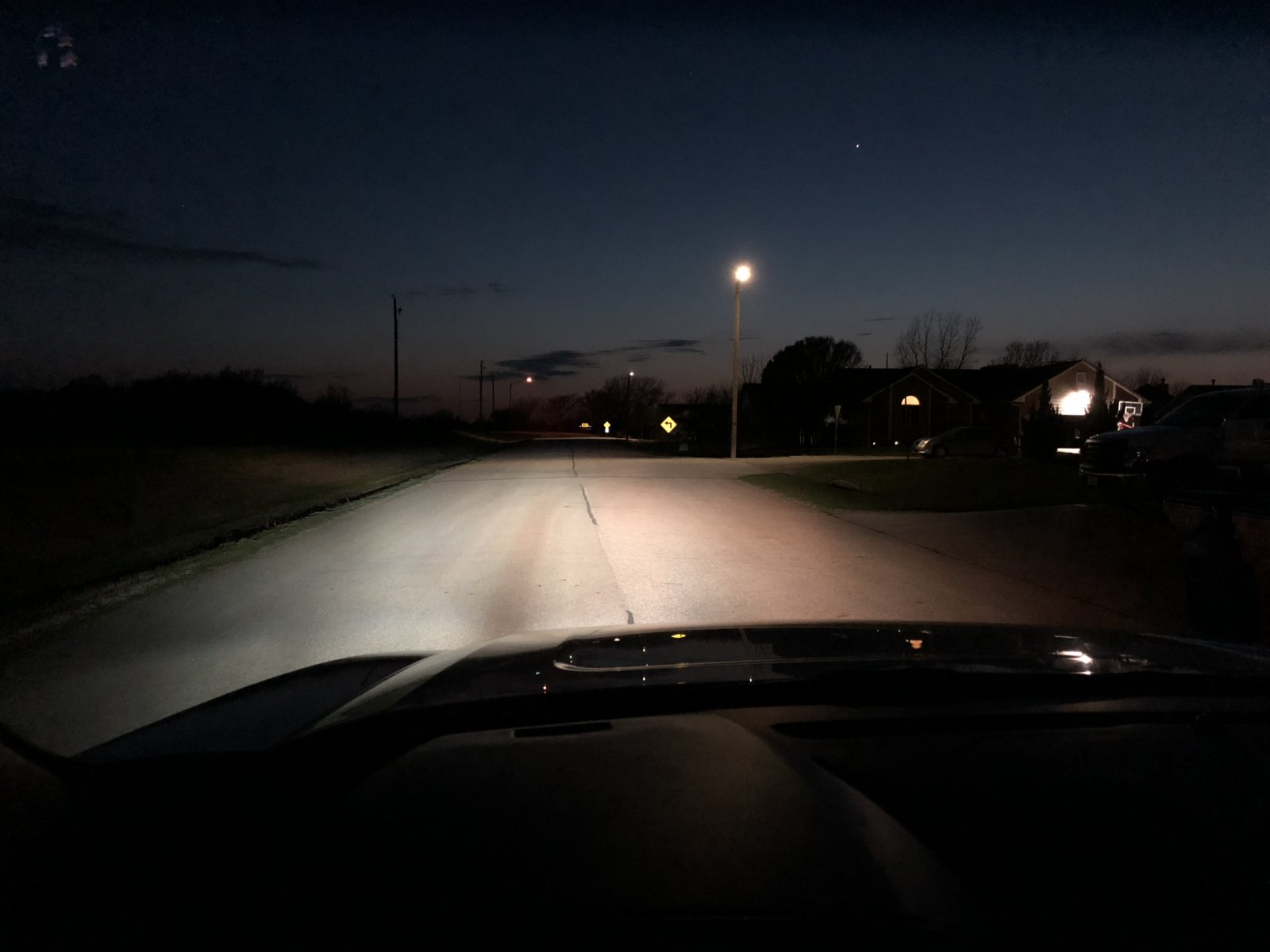

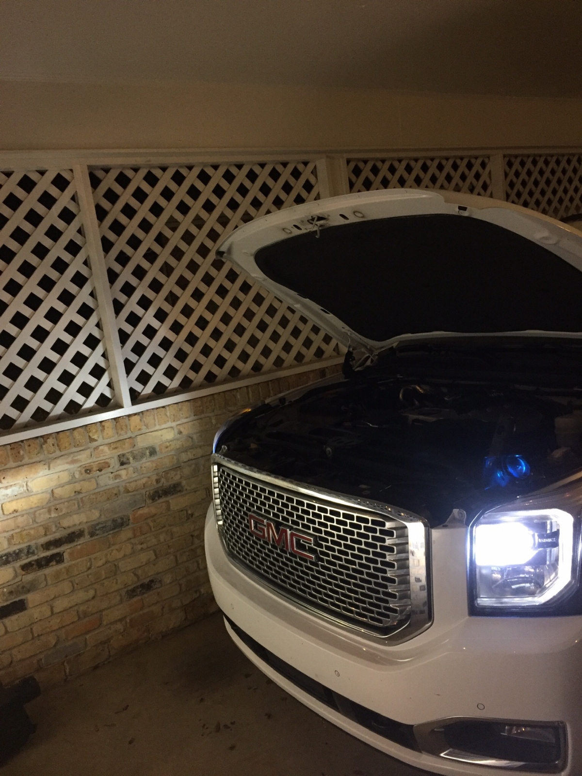

We have a 2017 Yukon. I bought 6K HID low beam kit, 6K LED High Beam Kit, and 6K LED fog kit from Vanquish Auto and have been happy with all of it. All super bright, no flickering, and plug and play.
Was happy enough with them that I bought the same setup for my 06 F250, but all LED. No HIDs in a reflector housing.
Here are a few comparison pics with stock halogens in pass side, and HID in driver side.3471057A-C472-4AFA-B03E-6C3DA530D2C9.jpeg 7F75E392-7D2D-40FF-B26D-D9850FC5F4C1.jpeg
