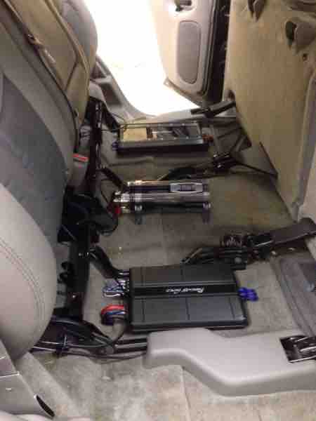

There is my setup, it's an 500 watt mono block and an 800 watt 4 channel. I run a 3.5 farad cap just to help a little. I upgraded the alternator wire and body ground to 4 gauge. I don't have a problem with dimming or anything on mine.

that looks pretty much like what i want to do. i gotta figure out how that carpet comes up to make it look clean like that lol.
as for my alternator - ive no idea what amperage it is, and my amps are still in the box. i'll pop them open this week and take a look. had to babysit this weekend is why i couldnt get back here to post :(
Easiest way to run the wires clean is to un bolt the middle row. You down have to remove it but once it is loose you can pick it up in the spot you are working in to help run the wires under the carpet.
